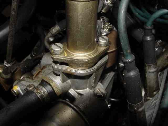

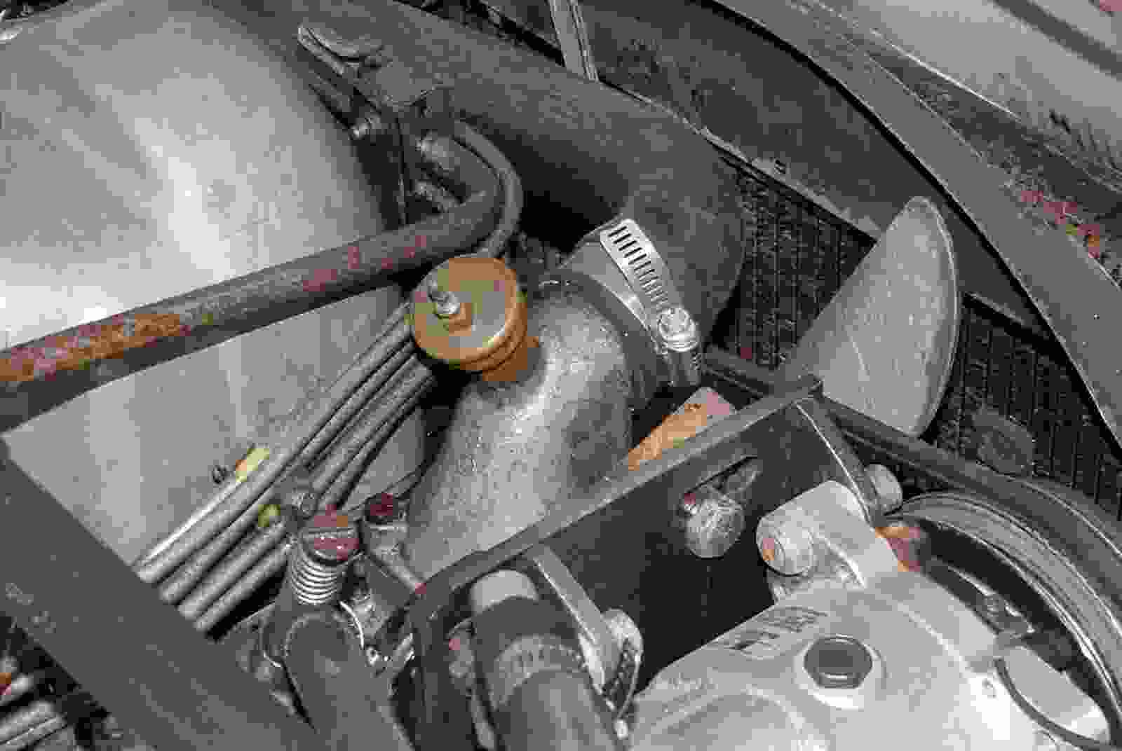

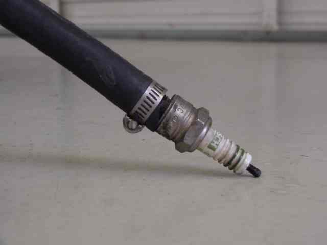

I took some pictures last night.  One of them is from my WRD showing the spacer.  The thermostat tower had calibration paint on the screws before I took it apart so I believe it to be new.  It will probably work just fine when I figure out the hose routing.  The photo of the throttle body shows the output hose connected.  The photo entitled “throttle body plug” is what I found when I removed the throttle body.  I am pretty sure that a spark plug doesn’t go there…  now you know what I am up against.  Anyone know how I can connect this?  George, I appreciate the image that you sent.  My car has no tube near the thermostat or front of engine.  I may try to find a “Y” fitting, so that flow will be unimpeded.  I was just hoping someone had seen a 280se engine in a 230sl chassis and remembered the output side of the throttle body being routed into a water flow fitting (just kidding).

I think I understand now.  Does your distributor cap have seven terminals?  I see where the 7th plug wire goes, I'll bet hooking it up will solve all problems :D !  I got a good laugh from the "plug" photo, looks like something I would have done 20 years ago.  Now, of course, I'd use an Allen head screw 'cause it looks better.
On a more serious note, the spacer in the WRD is correct, or at least my car and I believe most others have it, too.

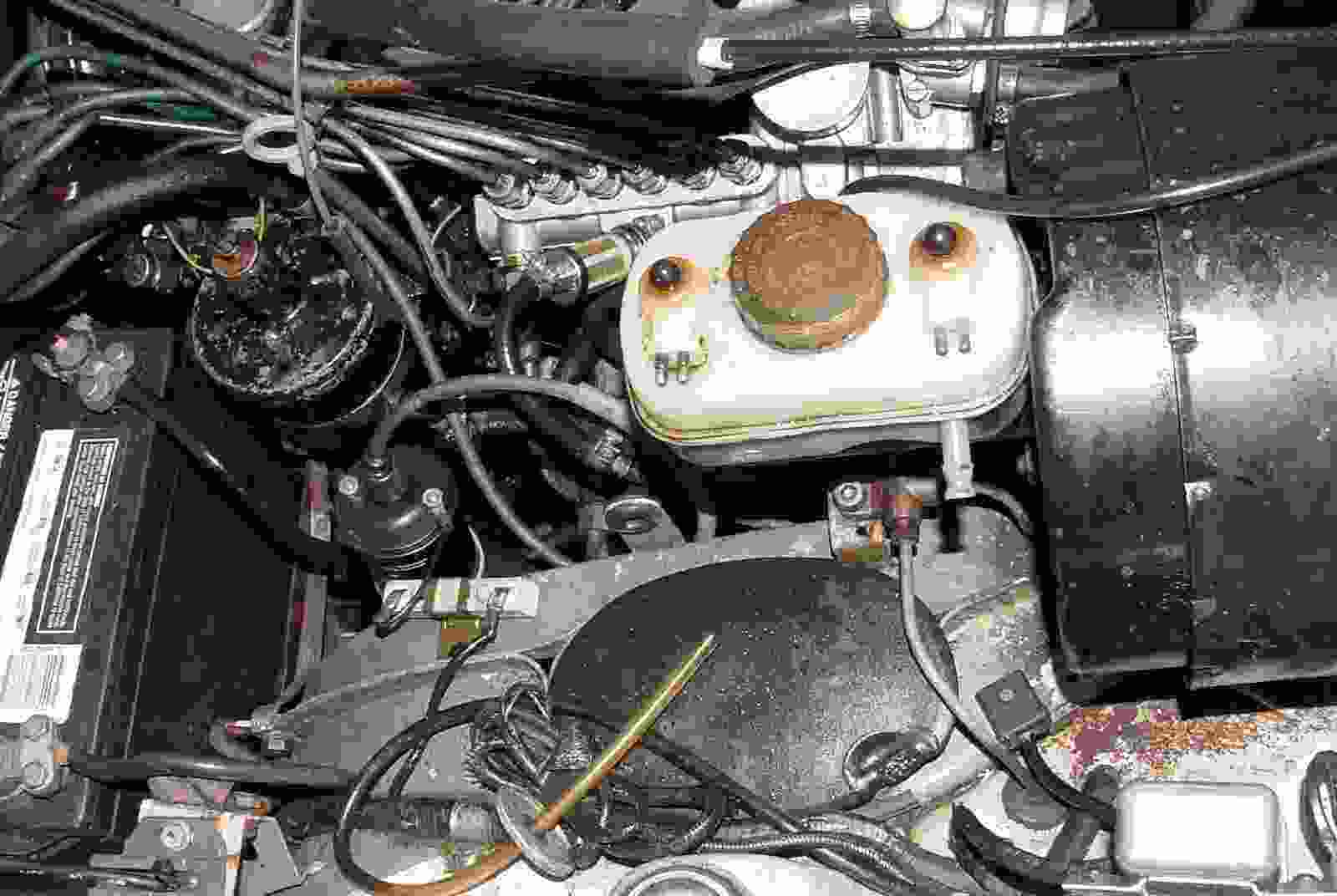

This picture might help:

Thanks George.  I was hoping someone would get a chuckle.  After turning the screws on the throttle body about 1mm before turning wrench/body for a new fit I wasn't too amused Saturday night when I found the "plug".  Now it seems more humorous.  I will take a couple of pictures of the front of my engine tonight Naj, it doesn’t have the handy little pipe, at least not that I have seen yet.  The saga continues.

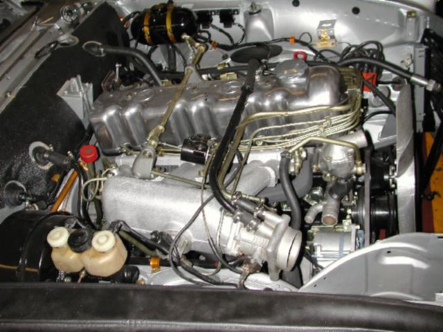

I took a couple of pictures to clarify what engine/chassis mix I have a little further.  However, I do believe that Naj is spot on with a 1970/71 280SE engine.  The shot of the thermostat area verified I have no pipe in the front of the engine, darn.  After looking at the throttle body closer last night, I will need a "T" that has 5/8" at 2 ends and a 1/2" at the "T".  May have to custom make something.
The driver’s side engine shot is for reference.  If anyone sees anything that jumps out at them please let me know.
The Mercedes home shot is to let everyone know that the car has found a resting place in caring hands, if not competent.
Ed
........at least its a Bosch plug !!  ;)
