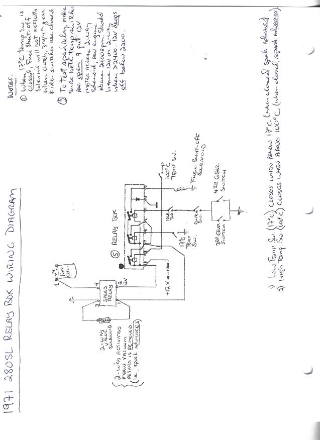

I'm new to the list and wanted to say thank you much for the good help available here.  I gave my 71 280SL to a Mercedes "expert" here in Western Washington to do an oil change, and to deal with heavy pinging on any kind of acceleration.  Well, he left out the upper filter element seal (the "garden hose" seal) and the car still pings badly.  Time to do it myself.  The list educated me about the often missing seals for the oil filter and also how the distributor advance system works.  I purchased the filter seals from my Mercedes dealer and my distributor is on its way to Dan Caron for overhaul.  Couldn't have done it without you folks.  I've attached a scan of the wiring schematic for the distributor retard (for my car) relay box that helped to analyse my ignition problems.  If I've made any mistakes in the schematic, please let me know.  Apologies if I posted this in the wrong place.
Will N. Stevenson

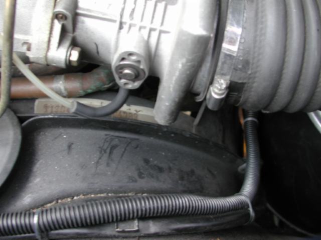

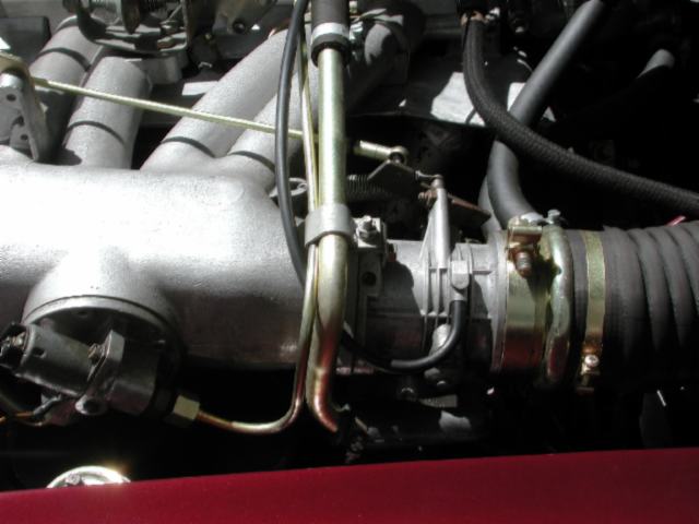

On the vac advance, the vac pick-up on the throttle body is in front of the throttle valve (air filter side) and there is zero vac at idling (throttle valve fully closed). Its also located on top of the body, (see picture)
Download Attachment: 230_3.JPG
36.95 KB
On the vac retard, there is high vac reading at idle and the pick-up is almost under and to the right of the valve body.

Nice pictures Naj. You might want to keep the second one on hand when/if anyone wonders where the VIN number is stamped - it shows it pretty clearly...

Hmmm, James,
The picture was taken for the Vin but served a different purpose today. :D

I just looked at my throttle body and it resembles your first picture. Although mine has a clear plastic tube (about 1/8) that runs over to distributor. Sound right for an early dist? And am I right mine is an advance type?

Hi, Naj,
My throttle body looks just like photo number 1 (vacuum advance) except:
- the raised casting where the hose is connected on your photo is just a solid piece on mine - there's nothing to connect a hose to or for vacuum to pass through (so to speak)
- my vacuum hose connects on the very bottom of the throttle body, two ribs further aft (that is, even with rib number 2 instead of number 4, if you think of the raised lines in the casting as ribs)
On another subject, if this is a photo of a 230SL, I wouldn't expect to see that water-heated ring between the throttle body and the air intake hose - we heard at Blacklick that those were only standard on 280SLs.
Thanks again for the help (and yes, ignorance can be bliss),
Yes, most engines have the white plastic tube running from the throttle body to dist. with just a small rubber bit at the throttle body end to connect up.
