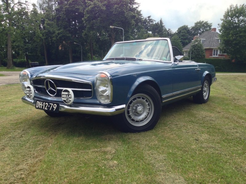

Today I had them fitted together with Bundt Alloys I bought on Ebay a couple of years ago. So now I have a set of old 113 rims (unused), 126 rims (with my Vredestein Winter tires for rallying in bad weather, these rims have fins on the inside which help cool the disc brakes...( I did tell you guys the story that once we were coming to a time control after a long, steep descent with a Bentley 3.5 ltr car on my tail threatening to shorten my chassis... I just managed to stay ahead of him but my discs were smoking when we finally stopped), and now, for a different summer look, the Vredestein Sprint Classic 185 HR 14 90H with ridge and classic profile on the Bundts.
Now all I need to do before Willingen and the 50th year celebration is address some of my rust spots...

Those alloys look like copies to me. Do they have a Merc part number cast in the back?

What tips you off to them being copies??

They may be copies, but have the raised steel inserts around the lug bolt hole and a 123 400 15 02 number on the inside. So, theyre not original for the 113, but 1970's style wheels for a W123, but close enough for me.
Again, how can you tell from this picture?

Very nice picture Peter!
33 years and counting!
There's a very subtle difference in the radius at the rim. Copy's radius is tighter than original's.
I've seen cars that have a mix and owners have been stunned to learn about it after owning the car for years!
