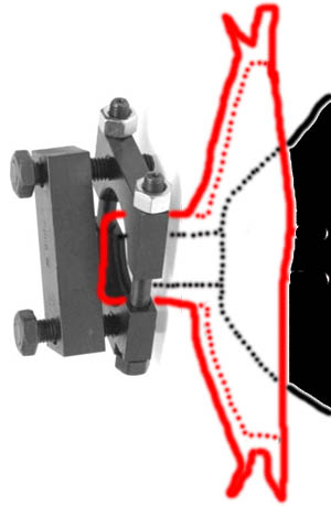

I can't tell fron the picture if the tool is the same as mine.  You absolutely can pull the pully with my tool.  Not sure whay you mean by 'indside' puller.  Can you see the groove on the pully hub?  I'll find a better picture of the tool for you.  Give me an hour or so.
Re: Removing power steering pump pulley
« Reply #5 on: June 16, 2004, 11:55:00 »
Cees,
You can find the pully remover that I used at the following site.  It resembles a bearing separator.  Hope the picture helps.  Look for part # M0006
www.sirtools.com/mercedes.htm

It looks like some of these special tools are almost unreasonably high priced. I just payed $73 (including $15 for shipping) for the Hazet valve adjust crowfoot. The M006 tool looks very neat. It took some time though before I understood where to put it.
Download Attachment: tool.jpg
33.79 KB
I managed to get my pully off by use of a three arm puller with just a lite torque while tapping gently. Many of you out there must have done this without the tool many times. How did you do it without bending the pulley?

Using the M0006 tool to remove the power steering pulley, the pulley is so stuck that the bolts thru the bracket that grips the pulley are beginning to bend. Got PB all over it. What to do? Keep going? Before anyone asks, yes, I have removed the end nut.

I tried the M0006, but it started to bend.
