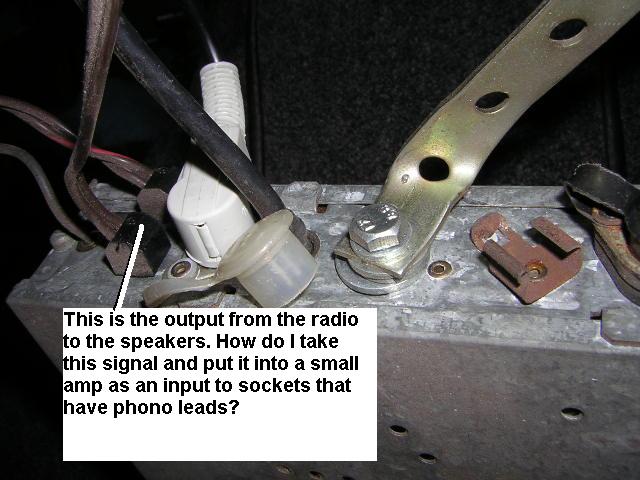

My '66 230SL came with a Europa 2 radio. It has sound, but there seems to be a fault with the internal gubbins of the wireless in that you have to max the volume to hear anything. I intend to try and fix. I have copied Ed Cave's excellent installation of a the MP3 wire into the ashtray on the car, and it works well. Whilst the radio is out, I would like to investigate fitting a small (100w?) amplifier under the drivers seat in order to be able to hear music whilst driving. I have 2 kicker panel speakers and do not want more. But I do want to hear the music.
My question: how do I take the output from the radio which I assume will be from the speaker terminals shown in the photo - be it from my radio signal or MP3 signal when the player is on - and feed it into the amp which takes photo leads? The leads I have seen in the shops all have those phono plugs on the end. As you can see from my attached photo of the back of my Europa 2, there are no fancy sockets in sight.
I am happy with the part that takes the signal from the amp to my kicker panel speakers. I assume I take a wire direct from the battery to the amp to give it power. Are there any other tips?
Please note that I am not trying to 'pimp my ride.' I just like music and would like to hear how others have put a modern amp in line with an older radio such as mine.

This may not be a direct answer to your question, but here goes.  Most Becker Europa II radios have plenty of volume without an amp, so yours is clearly defective.  Why not find another Europa II that works and use it.  That would be cheaper than buying an amp and trying to rig it to compensate for the weakness of yours.  Plan 2 would be to send your unit in to Becker for a refurbishment.  Used Becker Europa II's are not that difficult to find, nor are they that pricey.

Have you considered an amplifier with speaker-level inputs vice line level inputs.  These will allow you to take the signal from the speaker output of the Becker and put them directly into the amp.

I did not know one could obtain an amp that uses wire inputs vice line. Do you know of such an amp? I have searched a little and cannot find one.
Someone off line mentioned that I need some kind of "pass filter" because I have to use the wires from the speakers.
Genuinely confused. I would have thought that others would have done this install, actually, becuase of the weak powerout from the radios.

A band pass filter will not boost your output (no filter of any kind will). What it does is filter out all frequencies other than those in the band of interest. A graphic equalizer, for example, is a set of band pass filters.
If your amplifier is indeed bad, boosting its output will not likely produce a satisfactory signal. There's a good chance it will be distorted. I would correct the problem in the radio (or replace it) first. I would also try hooking up another source to the speakers to make sure there isn't a problem there (and vice versa, hook your radio up to another set of speakers). Did your kicker panel speakers ever produce satisfactory sound or has this always been a problem? What is the impedance of the speakers? The MB dash speaker is 4 ohm, if you've put in 8 ohm or higher it will affect performance. How are the kicker panel speakers wired back to the mono output of the radio? Are they in series or parallel?
Incidentally, you can solder a set of RCA jacks on the end of pretty much any wire. You can also cut a patch cord and strip the insulation, providing bare wire input on one end. The problem with using the output of your radio as an input to another amplifier is that it will be at too high of a voltage, possibly damaging your amp or speakers (or both). That signal would need to be attenuated somehow. I have read that it is possible to get a line level output from a Becker radio, but I haven't done it so I have no idea how.
When a repair person says it could be anything, they're telling you they aren't sure they'll be able to fix it. They don't want to build up your hopes.

Some Alpine amps (MTV-T420) have both preamp and speaker level inputs.

Crutchfield lists about 74 amps that accept speaker-level inputs (http://www.crutchfield.com/App/Product/Group/ProductMenu.aspx?g=120&tp=115&nvpair=AG_General_Features%7cYCSpeaker_Level_Inputs) They also have some good help links that describe the various inputs and outputs available on the amps.  Their helpline is also quite useful.

A final and inexpensive solution is just to purchase a speaker output to line-level converter from Crutchfields.com.  I've used one of these, both in my home stereo for long runs, and in my car.  It is only $19 and a very simple installation.
see:  http://www.crutchfield.com/App/Product/Item/Main.aspx?g=721&i=142SLC4&search=adapter&tp=2001
Its called a Scosche SLC4, Crutchfield Item #142SLC4

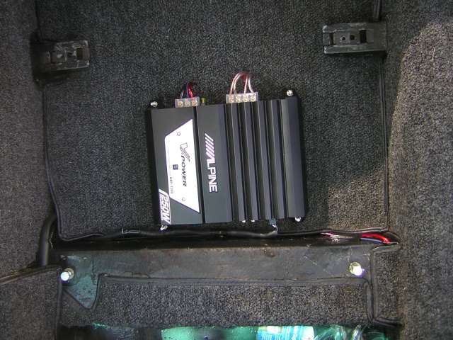

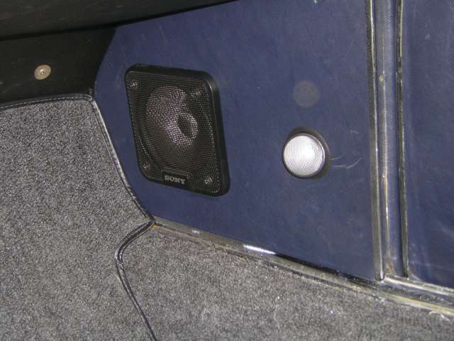

I have finally finished putting the amplifier into my car. I've had it for several months but made a concerted effort to crack it this weekend. It actually took all weekend, as I found some rust that needed sorting.
The car had a Backer Europa II and some very old 5.5 inch sony speakers. I was not trying to pimp my ride, but simply wanted to be able to hear the music whilst driving. I replaced the sony speakers with Infinity Kappa 50.7 woofers and also put the matching tweeters in the foot well. I have placed the 50W Alpine amp under the drivers seat, where it fits nicely. The crossovers are hidden in the dash.
Because of the fiddly nature of the job (replacing the wiring and cutting holes for the tweeters, I did not exactly enjoy the work. However, now it's done I am pretty happy with the result.
Here is a photo of the amp just before the seat is replaced. There is also a photo of the tweeters. I elected to keep the original (to me at least) and old sony grilles as the new Kappa ones are somewhat flashy.
The photo of the tweeters has a strange circle above the tweeter - my kicker boards are not that dirty! (The camera, however, is).
JH
