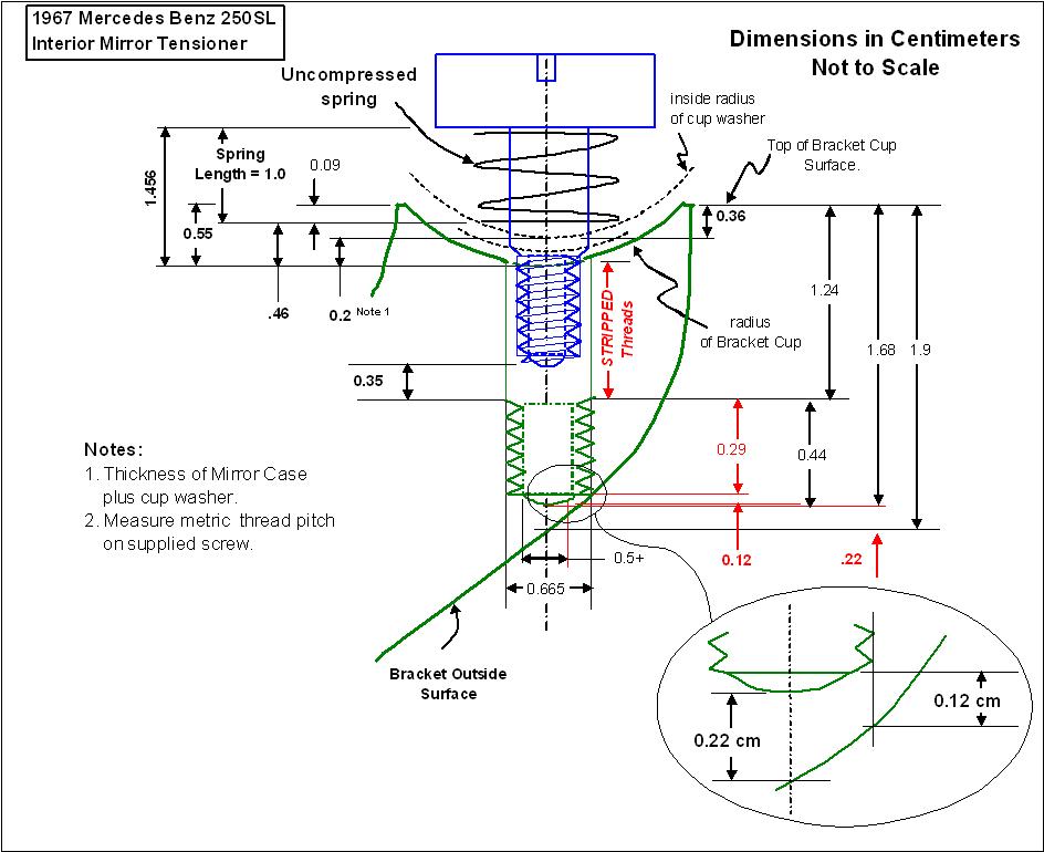

My interior rear view mirror was getting loser, so I took it apart to tighten the tension and found that the threads on the goose-neck tapped hole were nearly completely stripped.
I'm thinking a helicoil insert to fix, but since goose-neck material is pot-metal, I'm worried that drilling out the hole for a helicoil might fracture/crack the end of the goose-neck surrounding the tapped hole in the process.  Any other quality methods of fixing this problem permanently?
UPDATE #1:
Before checking with a machine shop to determine viability inserting a helicoil, I was curious about how & why the tapped hole threads became completely stripped... and why the mirror tension failure occurred after over three years of having had no problem with it.
The reason the tapped threads are stripped turns out to be related to the tension created by the tension spring under compression... and the compression required to get at least 3 of the total of 6 threads engaged is approx. 50% of the spring length.  I haven't yet measured the force under 50% spring length compression, but I can't compress it to that level by hand!, so the force required to get 3 threads engaged will be relatively larger than I'd thought.  The uncompressed spring length is 1 cm.  The tension bolt's tip has a clearance to the 1st thread before compressing the screw of approx. 0.34 cm... and another approx. 0.21 cm to get 3 threads fully engaged... 0.55 cm total compression required for 3 threads engaged.  To engage all 6 threads requires another approx. 0.21 cm... so a total spring compression of approx. 3/4's of the spring's length.  That would require full spring compression... all turns bottomed out on each other... .which is extremely excessive in terms of force.
Moreover, since the spring needs to be compressed by approx. 1/3rd it's length just to get the 1st threads to engage, it's very possible under that compression force to easily & unknowingly cross thread the bolt into the tapped hole.  This is likely what occurred at some time prior to my ownership.  When I disassembed & reassembled things 3 years ago I was apparently able to get a couple of cross threaded threads engaged/wedged with sufficient tension / compression to hold the mirror in position.  With cross threaded conditions however the force on the remaining remnants of threads eventually pulled the tapped metal (pot metal) threaded / wedged points loose, hence my problem with no longer being able to hold the mirror in position.
What I can't understand though is why the design uses such a large spring.... with length that requires approx. 1/3rd spring compression just to begin engaging the bolt threads with the tapped hole threads.
UPDATE #2
On more careful examination, it turns out that clearance hole in the mirror bracket isn't a clearance hole afterall... it's actually all stripped threads!!!!
This make far more sense from design point of view, since screw would engage the tapped threads long before the spring get's compressed at all.  As to cause of totally stripped out threads in the 1st place, all I can surmise is that the threads were stripped out by prior owner and that I'd been able to engage only 1 or 2 remaining threads at the bottom when I'd re-assembled the mirror 3 years ago... which required excessive spring compression, hence tension on the 1 or 2 hole threads I'd been able to engage... and therefore that the force under that compression exceeded the ability of the metal to withstand that force over time.... therefore eventually giving out and leaving me with the dangling mirror a few weeks ago.
The precision machinist said he can install a helicoil without damaging the bracket.  The helicoil doesn't have to go the bottom
of the existing tapped hole since the screw wouldn't be able to get to that depth anyway due to the amount of compression that would be required on the spring.  It's obvious from the length of the stripped threads (now) that the most the threads had ever previously been engaged was by no more than ~ 0.35 cm beyond the uncompressed spring position... or maximum of approx. 1/3rd spring compression.

See attached picture of the relation of the screw to the tapped hole in the bracket with uncompressed spring. Dimensions are my measurements or calculated... accuracy only to +/- 0.02 cm (0.2 mm) though.  The tapped hole in the bracket should have threads all the way to the bottom of the spherical cup --- unlike my stripped thread bracket.
