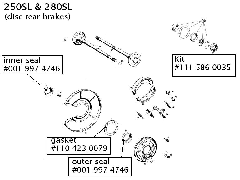

     (1) right side axle wheel bearing "roller cylindrical bearing"  #000 981 152
     (1) left side rear wheel bearing "ball bearing"  # 001 981 1525
     (1) seal and gasket kit # 111 586 0035 which includes the following parts or can be ordered separately:
                   (1) inner oil seal # 001 997 3446 (correction 5-09)
                   (1) outer oil seal # 001 997 4746
                   (1) paper gasket # 110 997 47 46
                   (1) lock plate # 183 353 0373
                   (1) special grooved nut (optional, but comes in the kit) #153 357 0026
     (2.5) quarts of 90w or equivalent gear oil

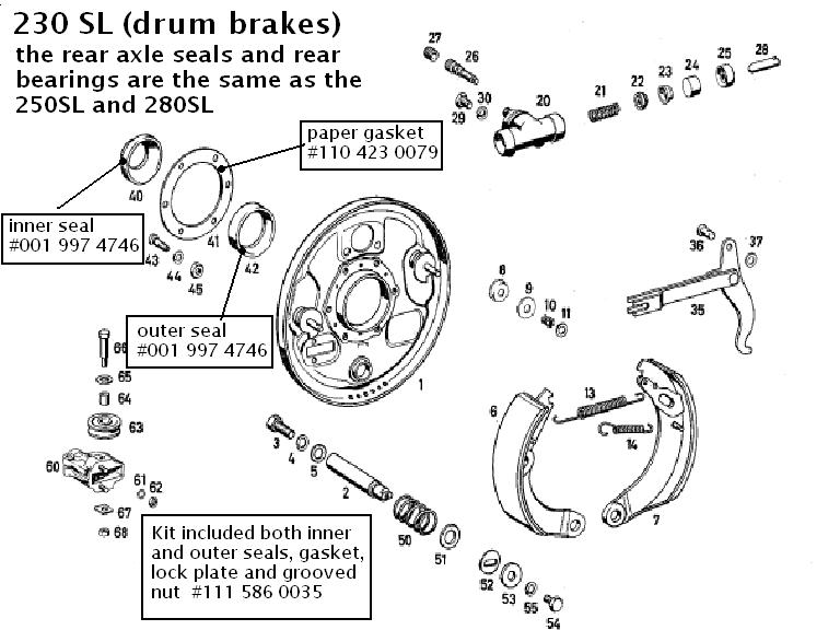

Here are diagrams, the 230SL has drum brakes so we have no photos of its brke assembly, but the basic procedure is the same except for the brakes. I will try to fill in some 230SL specific information as we go along.

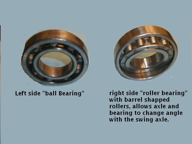

This swing axle differential  has two oil seals on each axle The inner seals isolate the differential 90W oil from the wheel bearings which are packed in bearing grease. The outer seals keep the bearing grease from getting into the brakes.
The right side of the swing axle must be able to hinge with the suspension and the right side wheel bearing is a special barrel shaped "roller bearing" which can actually hinge with the axle.
This right side wheel bearing is three or four times more expensive than the left side "ball bearing".  Fortunately since "roller bearings" are designed to handle higher loads than a standard "ball bearing", this expensive right side "roller bearing" seldom fails. View the photo below;
 Download Attachment: bearing types.JPG
31.02 KB
Since the rear wheel bearings are isolated from the differential oil, running the car with a low oil level in the differential will not normally cause these bearings to fail. Long term storage, dried out bearing grease, and normal usage may eventually cause a bearing failure. If left in use the bad bearing may  seize and may begin to spin inside its seat in the axle housing, wearing the casting itself.

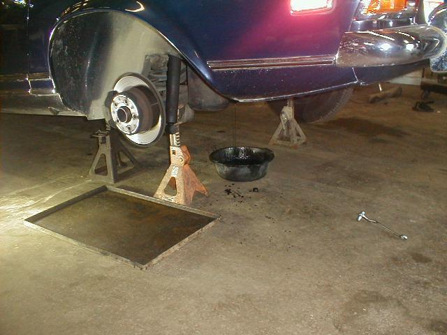

The first step is to place the rear of the car on jack stands and support the rear axle so it is as level as possible.

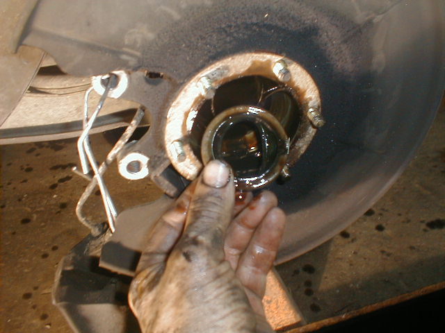

A 14mm drain plug tool is used to remove the drain plug at the bottom of the differential casting, allowing the 2.5 quarts of gear oil to drain.
Download Attachment: drain fluid 2.JPG
49.51 KB

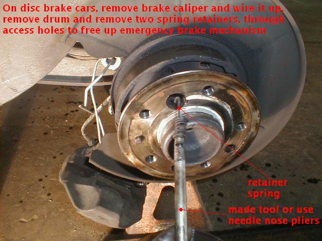

Disc brake cars have a complex emergency brake arrangement, while drum brake cars have the usual complexity of springs and shoes. Pay special attention to the arrangement in either case.
Disc brake cars have two large holes in the axle wheel hub so the spring retainers holding the emergency brake shoes in place can be removed. Needle nose pliers or small needle nose vice grips can be used through these openings. An old screwdriver can be modified to work as a simple removal tool also. In any case the axle must be stripped of it's brake and emergency brake assemblies.
Download Attachment: retainer 3.JPG
59.35 KB

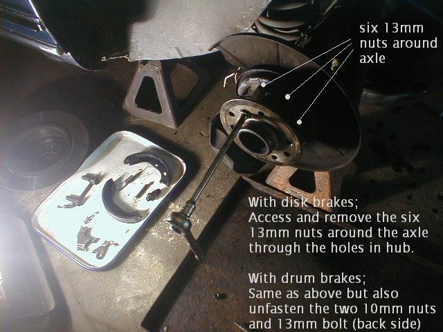

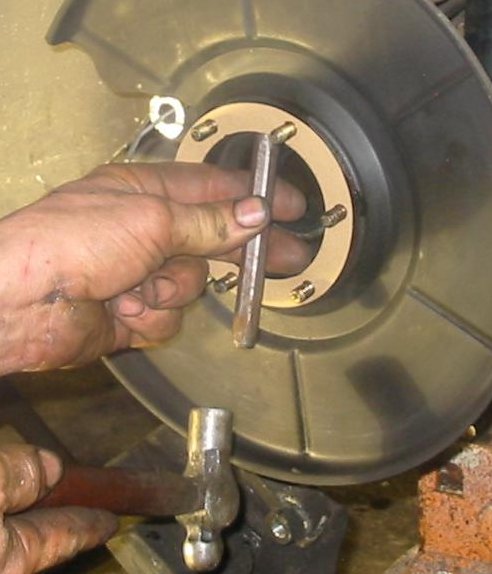

The brake backing plate or beaing retainer is held on by six 13mm nuts around the axle. These  can be removed using a socket through the holes in the axle hub.
Download Attachment: axle4.JPG
61.48 KB
Drum brake cars will also have to have the two 10mm nuts holding the emergency brake pulley assembly (#20 on the 230SL diagram above). An additional 14mm bolt (#2 on the 230SL diagram) also must be removed behind the brake backing plate on the drum brake cars.

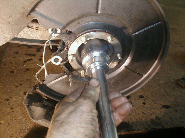

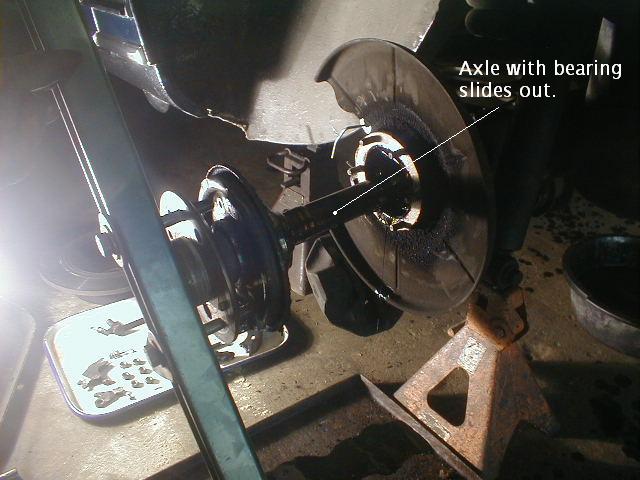

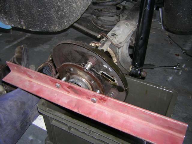

The axle should be ready for removal at this point. In place of the expensive special axle puller, bolt a piece of angle iron or uni strut to the axle and tap it out with a hammer (see below).
Download Attachment: axle removal5.JPG
56.1 KB
Download Attachment: axle out 6.JPG
50.72 KB

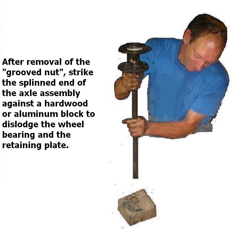

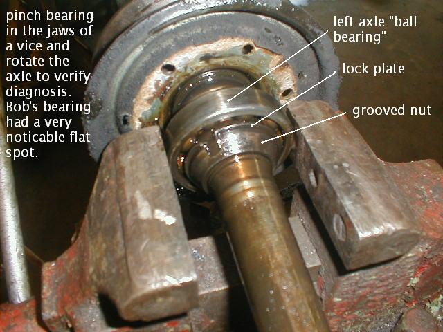

Remove the axle assembly with bearing. Confirm the diagnosis by slightly pinching the bearing in the jaws of a bench vice and turn the axle. The slight pressure of the vice on the bearing will simulate normal load on the axle. You will feel a definite flat spot on the defective bearing as the axle is turned.
Download Attachment: vicetest7.JPG
60.26 KB

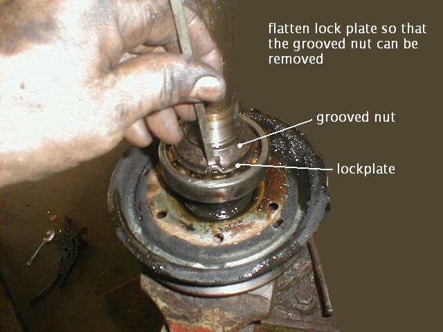

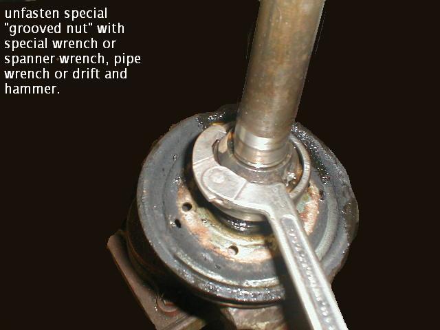

A special "grooved nut" holds the bearing in place. The grooved nut is locked in place by a lock plate which is bent up into the grooves of the nut. Grind a punch so as to fit the groove and straighten the lock plate enough to release the grooved nut.
Download Attachment: axle 8.JPG
40.7 KB
The grooved nut can be loosened by use of a special tool, or a spanner wrench, flat drift or even a pipe wrench.
Download Attachment: grooved nut 9.JPG
35.82 KB
The axle bearing must be removed next. The BBB shows a very special and expensive puller, your local NAPA or automotive machine shop can press it off. I use another simple trick. Place a block of aluminum or hardwood on the floor. Strike the axle assembly splined end down firmly on the block. With one or two blows the bearing should pop off, (see photo). This method has worked many times for me. Do not use anything harder than aluminum or wood or you may distort the end of the axle.

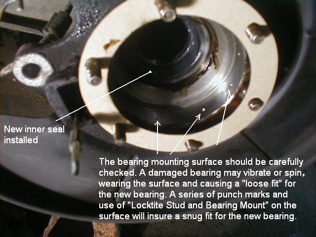

The old axle seals can easily be removed next. The inner seal located in the axle tube can be tapped with the drift by hitting it inward in one spot so it will twist so it can be pulled out.
Download Attachment: inner seal 12.jpg
62.44 KB

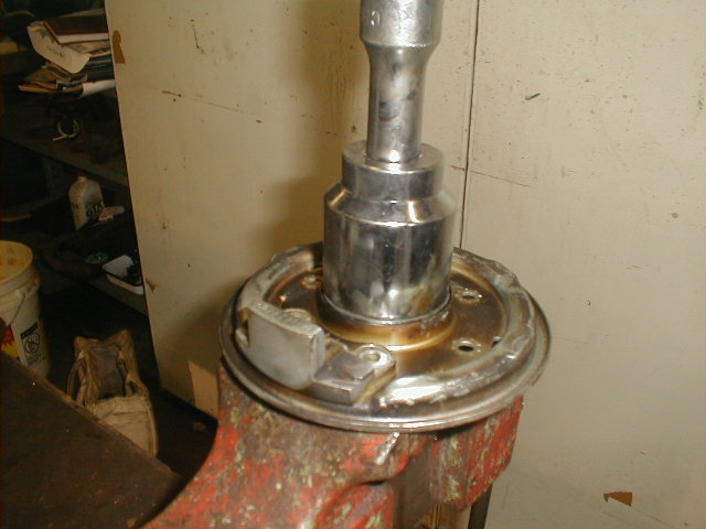

The next photo shows the installation of a new seal using a large socket to drive it in place. I coated the outer surface of the seal with gasket shellac to insure a good leak proof seal against the axle housing.
Download Attachment: install seal 13.jpg
60.18 KB

The bad bearing can vibrate or actually spin in the housing, wearing away it's seat. A highly polished suface in the housing can be a sign of bearing rotation in the housing. You can tap a series of punch marks arount the circumference of the housing and also use "Locktite Stud and Bearing Mount" or equivalent to insure a good snug fit for the new bearing.
Download Attachment: housing16.JPG
45.6 KB
Download Attachment: housing17.jpg
59.43 KB

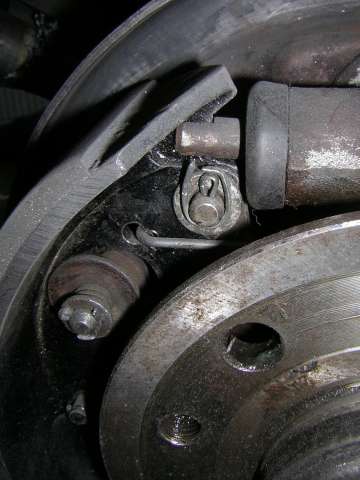

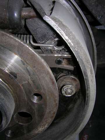

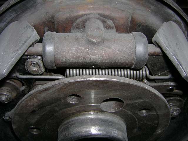

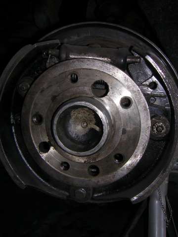

We already had the drums off to change the brake shoes, but here's a few photos of the brake assembly when assembled (taken at the end of the process):
Download Attachment: DSCN1211.jpg
27.47 KB
Download Attachment: DSCN1210.jpg
46.63 KB
Download Attachment: DSCN1212.jpg
31.87 KB
Download Attachment: DSCN1213.jpg
31.76 KB

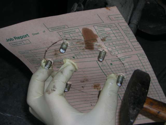

Pulling the cover plate off was easy - a tap from the rear and it falls forward. We used Joe's puller design to get the axels out:

Unless I'm mistaken, it seems that the rear wheel bearing part numbers have changed. The part numbers I have for the cylindrical roller bearing is 000 981 05 06 (list $120) and for the regular ball bearing is 008 981 42 25 (list $21).  You might consider updating your original post with this information.
I have another question: the EPC shows the cylindrical roller bearing used only on the V8 cars' rear axles (both sides). This is presumably because of the higher torque. However, all the 6-cylinder cars I checked showed up as using the ball bearing on both left and right sides.
So why is it that we feel the need to use the roller bearing over what MB recommends?  If we're just simply taking precautions by using the higher load bearing, then why not use that precaution with both sides? (left and right)   I understand the right side undergoes a different set of stresses due to the swing axle, but why would MB not recommend the roller bearing if it was indeed necessary?
Never mind. I just went through the Technical Data Book (Issued October, 1969) and it clearly shows the cylindrical roller bearing used on the right but not the left. I'm either not reading the EPC correctly, or the EPC is wrong.
