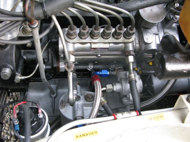

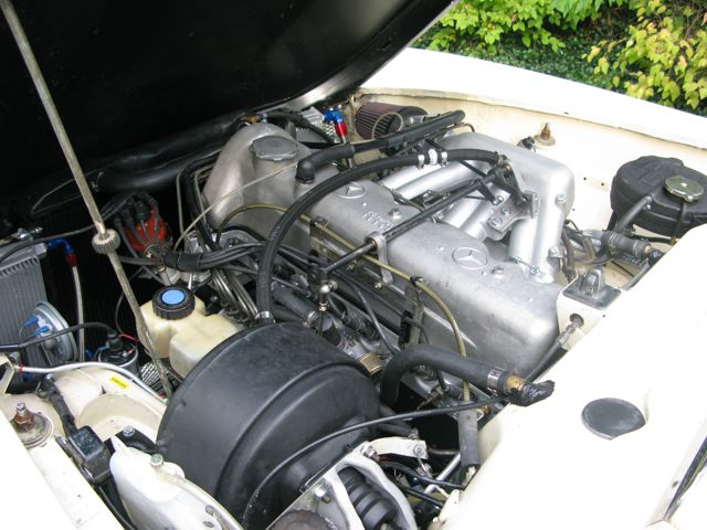

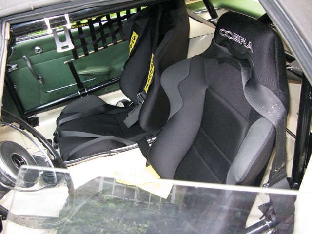

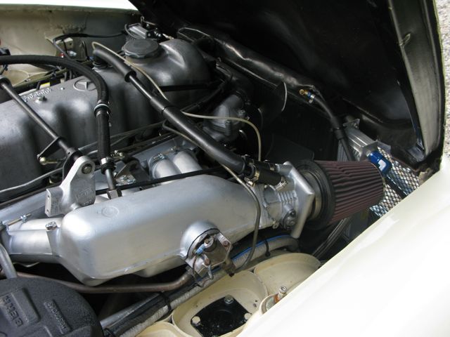

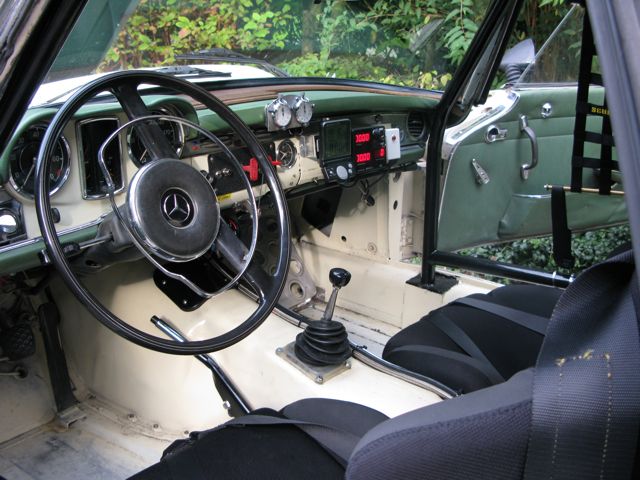

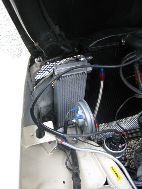

Although he has a prized, and beautifully restored 190SL which he did mostly himself, his 230 SL which he shipped to Mexico yesterday will not win any points at a car show. The car has been totally prepared for rough rallying. It has a full roll-cage, a transplanted 280SL engine with a 4 speed gearbox, a 123-ignition, a racing fuel tank, a fuel cooler and oil cooler, upgraded variable shocks, vented disc brakes and so on. All feature comforts have been stripped. I drove the car yesterday and I assure you, it's noisy.
He's got full harness rally seats and the usual accoutrements of meters and stopwatches for the navigator. Have a look at the photos below.

He's got a shield protecting the radiator and his two coolers. The underbody has been cleaned and repainted and protected using a special rally car compound... don't know what it is called exactly. He's routed fuel lines etc through the cabin along the transmission so that it cannot be damaged by stones.
He's got an automatic fire-extinguishing system with lines and nozzles spraying into the engine compartment and the passenger area.
