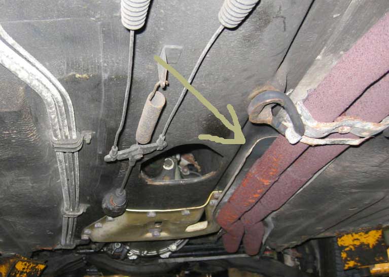

Re: Engine heat
« Reply #6 on: September 09, 2008, 04:11:55 »
Just to add that there should be a heat shield under the car between the exhaust pipes and the floor under the passenger seat. Not sure if this is your problem but without the shield, the passenger floor can  can get quite warm.
The shield is a steel plate about 1/8 inch thick, maybe 3 feet long. The slightly curved left edge fits between the pipes and the floor while the right side is screwed to the floor pan. It goes above the exhaust pipes where they pass below the passenger seat area.
The shield is in 280SL's...not sure if it was installed in the earlier cars.
Probably a good idea to fashion one from scrap plate if it is missing.
The arrow in the photo points to the edge of the shield.
