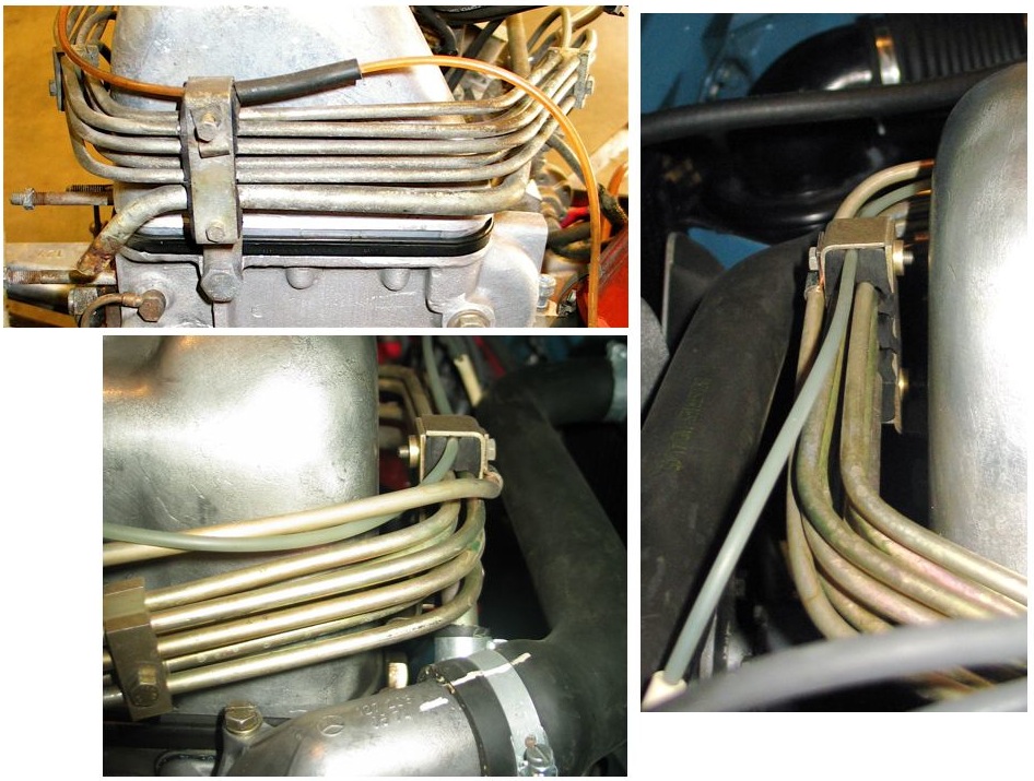

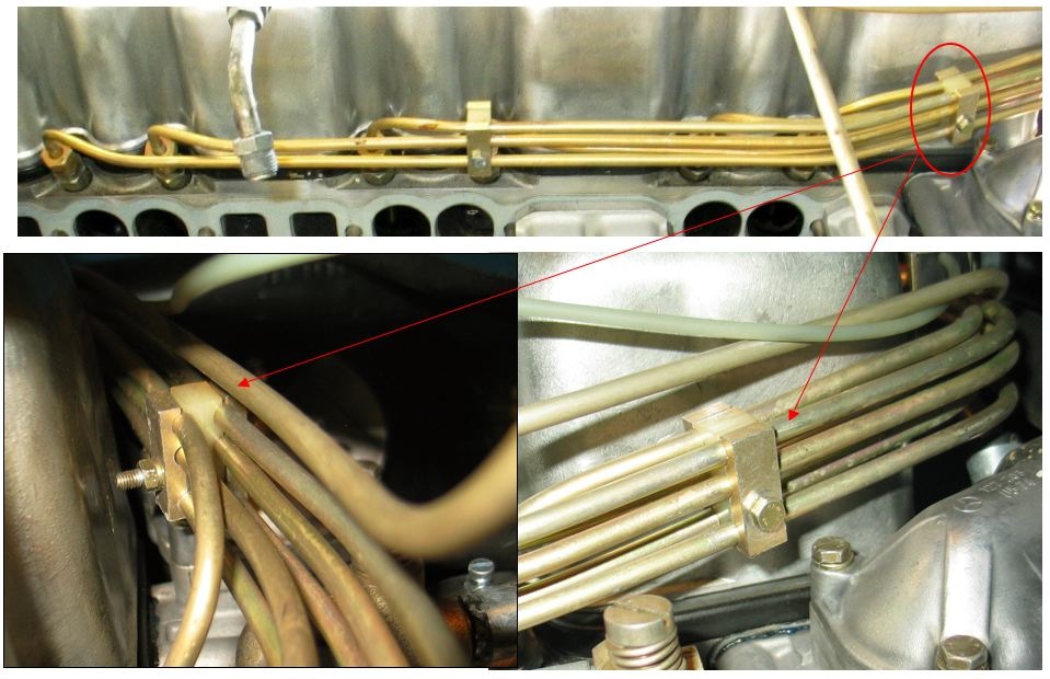

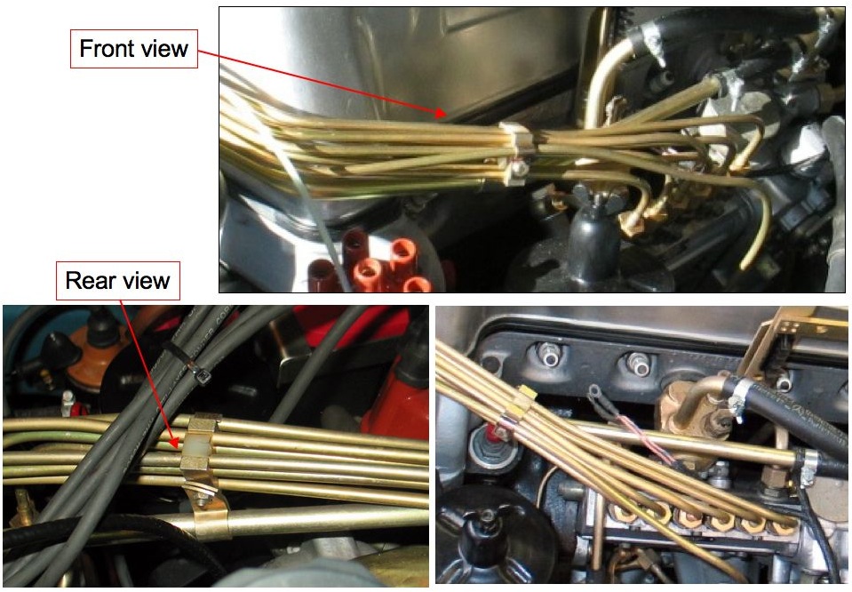

Paul,
here are some pictures that might help you to align the pipes, although my brackets and plastic inserts may not be exactly the same as yours.
Do a trial first, that is, install the brackets without the injection lines attached to the IP and engine.  That will give you an idea how they fit together.
Good luck!
Download Attachment: Brackets.JPG

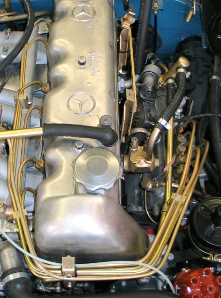

Re: F/I lines separating brackets
« Reply #2 on: September 10, 2008, 06:20:07 »
Take a look at the link in my signature.  There are a number of pictures of the engine that may help.

  • Posts: 4769
« Reply #4 on: September 10, 2008, 21:41:28 »
Paul,
there should be a bracket at cylinder #4 that grabs 3 injection lines, although if you look at the SLS web site the brackets available now have only 2 grooves. I guess that is still better than nothing.
I am not sure if you keep the lines attached at the IP whether you should really start as far away as possible rather than the first one in line next to it.
This bracket grabs the six lines in two rows of three each. If you number the lines coming out of the IP 1 - 6 from left to right, then line 6 is on top of 5 which is on top of 4 on the engine side of the bracket. On the front side of the bracket you have line 3, 2, and 1 from top to bottom.  First slide the plastic inserts over the lines and then the metal parts.
Now be careful how the cooling water pipe that goes to the WRD is attached. On a 230SL it is at the bottom and not on the top as shown in John L's picture of his 250SL!!  Take a close look at my pic of the rear view (meaning looking at it from the passenger side of the engine) of this bracket.
On the front of the bracket you attach the fuel line that goes to the CSV. It also attached the same way on the front bracket.
However, the caveat in all of this is that mine is a late 230SL and yours is an early one. Perhaps James Huber can take a look at his early 230SL and tell us whether there are further differences.

  • Posts: 4769
« Reply #6 on: September 10, 2008, 23:18:13 »
Hi Paul,
are your lines too far apart horizontally or vertically?
And how far - 1/8 inch or 1 inch?
Lets make sure we are talking about the same bracket - it is the one closest to the IP, correct?  This one is asymmetric, that is, lines 6&5 and 3&2 are closer together than 5&4 and 2&1. See picture.
If your lines are too far apart horizontally then I would certainly try what you had in mind and loosen them a bit at the IP so that you can squeeze them together to fit the grooves in the plastic.
If they are apart vertically then I would first make sure that they are attached in the correct order.  In the absence of any brackets, can you attach each line from the IP to the corresponding injection point without much strain in the line?
If they are in the correct order then I would fix the lines to the bracket first and then screw them on to the IP. The lines can be bent a little bit - with care and a gentle push!
