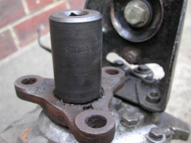

Dalton, the pin socket I bought is from SirTools.com. I can't remember the part number and there aren't any markings on it. It was the only one they showed. I originally got the tool part number from Naj. I believe he had purchased and used one so it must have been right for his car.
The one for the gearbox is M0029.
The nut on the diff is different and uses M0030.

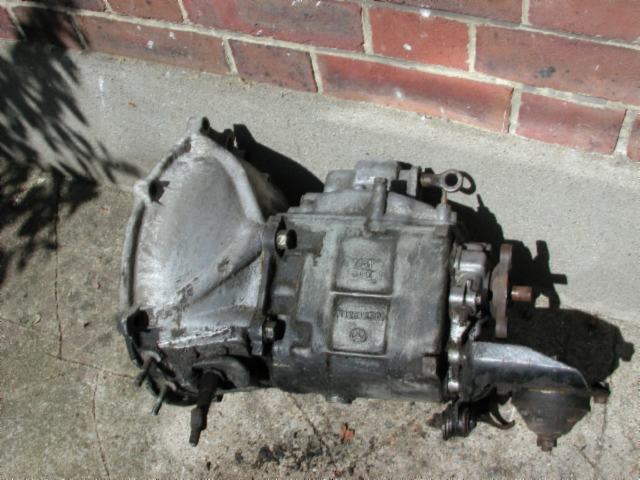

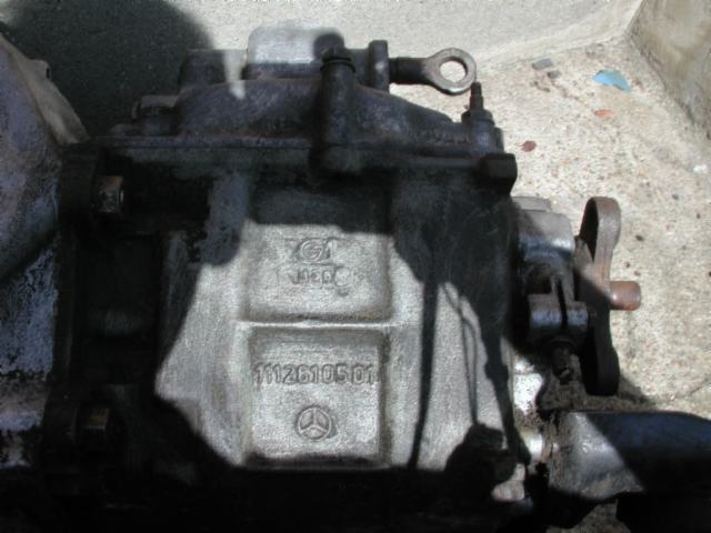

Hello, Joe,
220 Gearbox I was talking about:
Casting # 111 261 0501
Download Attachment: Gbx220-10.JPG
53.32 KB
Download Attachment: Gbx220-13.JPG
42.01 KB
Sir Tools M0029:
Download Attachment: Gbx220-15.jpg
33.36 KB
« Last Edit: November 26, 2005, 15:07:38 by naj »

Great stuff Joe.........looking forward to it !
Naj that look identical to the 113 transmission. I have a spare so I could check those numbers if you want !
Re: Standard Transmission Tour
« Reply #6 on: November 28, 2005, 06:32:23 »
Ben,
Yes please!
Also check the change-speed lever - the one with the big hole.
It may be angled down???

Naj the top rod attachement is bent down on the 113's. I have read that the top cover should be changed over, maybe this is why !
Either way I will dig it out and take photos/check numbers but it could be a day or two ok !
  • Posts: 7513
« Reply #9 on: November 29, 2005, 11:18:44 »
Hello Ben,
Yes many of the sedan transmissions are identical except for the gearing, sometimes just first gear. You can look up the gear ratios for all the gears in the Technical Data Booklets. The easiest way is to remove the cover and simply count the teeth on each gear if you are not sure what you have. Many of the sedans had a very low first gear.
The Top cover is different on the W113 as the shift rod "goose necks" downward to clear the tranmission tunnel. These cavers are interchangable.
