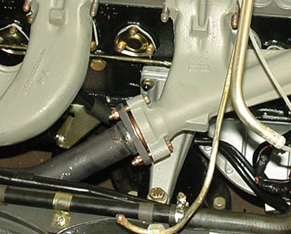

Hi All!
Just to confirm....  which side do the copper nuts go on?  The manifold side (as pic below) or the downpipe side?
Thanks!
Bob  :)

« Reply #6 on: July 13, 2008, 08:00:31 »
Mine are as pictured, manifold side.

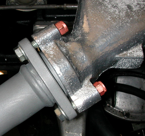

« Reply #9 on: July 13, 2008, 19:34:56 »
Hello Dr.
Somehow these are installed the impossible way?  It was when I saw this photo that I was curious as to which way is correct.
ps. I dont fish....
Originally posted by Benz Dr.
You guys should stick to fishing..... ( lol )
It's pretty clear which side the nuts go on. You can't put the screws on from the top as they won't clear the manifold casting. The nuts aren't made from copper either. If they were made from copper they'd stip out well before you ever got anything tight.They're 'copper plated ' so they won't rust. This helps prevent siezing but won't stop it completely. I use a bit of anti-sieze on the threads just to make sure.
How tight do you put the manifold nuts? Tight! Not just a little bit tight or snug, you want them on there until the nut quits turning.
 On the exhaust flange there's a small O-ring that goes in there and you have to crush it so there will be a good seal. If this isn't as tight as it will go the pipes will leak or come loose from vibration.
  • Posts: 7276
Re: Exhaust/Intake manifold
« Reply #10 on: July 13, 2008, 21:32:13 »
Well yeah, on the front one you can do that. On the back one there's a spot or two where you can't. Either way it doesn't matter as long as you get them fairly even and tight.
