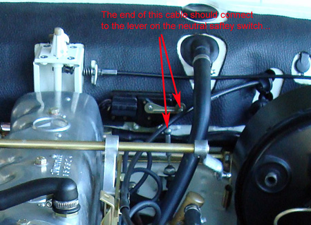

« Reply #4 on: August 11, 2008, 11:28:23 »
Attached is a picture of my neutral safety switch.  Note that in the picture it is disconnected.  Just yesterday I connected it.  I found the easiest way to install it correctly was to move the lever until the backup lights came on (key on, engine not running). Move the gear shifter in "R" reverse position.  Then adjust the cable so that it connects to the lever.  I adjusted it by means of the 17mm nut.  Run it through the gears (park, neutral, backup, etc...).
You will note that in Park, the lever is all the way down.  In drive, the lever is up.
Bob  :)
