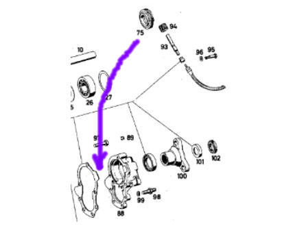

The drive and driven gears for the speedo are located behind and alnog with the rear cover of the transmission.  The drive gear (#75) is not keyed to the output shaft of the transmission.  It is held in position and rotates with the output shaft by contact and friction with the output flange(#100) and 4 pin nut (#102).  See the attached pic.  It the pin nut is loose the drive gear can slip on the output shaft causing the speedo to be erratic.  You need to move the drive shaft out of the way to see the nut.  Once you have gone this far you may want to replace the rear cover gasket and oil seal.  Same can be said for the flex ring and mid drive shaft bearing.

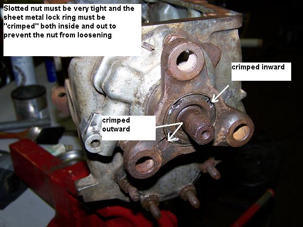

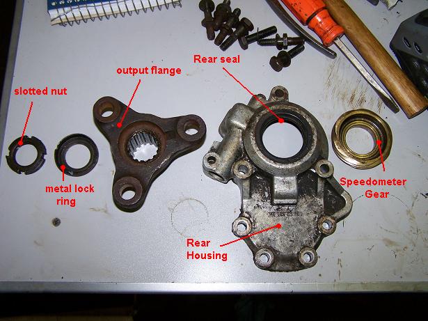

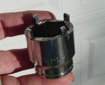

Check the slotted spanner nut for tightness. If it is loose it must be re-tightened. A special four prong socket is still available from Mercedes for these nuts. Some mechanics make their own with a die grinder  and a 1/2" drive 1 1/8"   deep well socket.  In a pinch the nut can be driven tight using a drift and hammer (not recomended).  The sheet metal lock ring must be "staked" outward and inward to prevent the slotted nut from comming loose again.

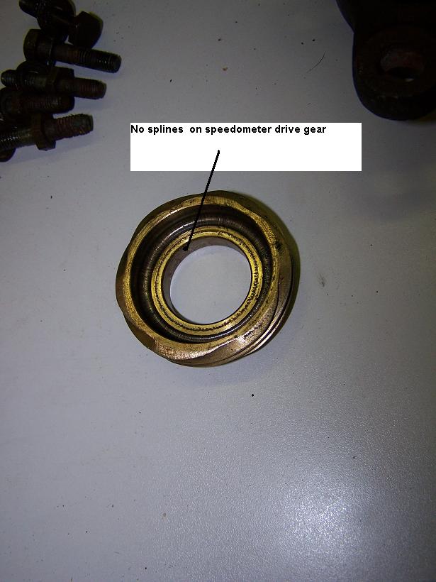

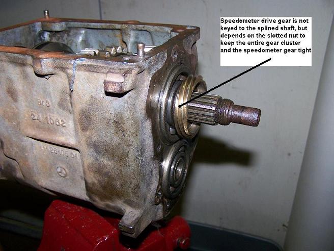

This is a  picture of the speedometer drive gear. Notice it has no keys or teeth on the inside to keep it from spinning on the shaft. The pressure from the tight spanner nut keeps it from spinning. If the spanner nut comes loose the gear can no longer function correctly.

Download Attachment: parts.JPG

Here is a picture of the gear on the shaft;
Download Attachment: shaft2.JPG

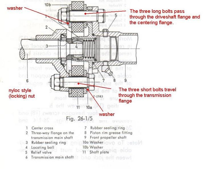

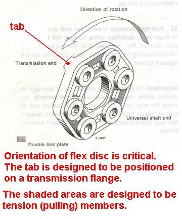

Before re-instlling the flex disc, check it for conditon also note that the three tabs on the flex disc MUST be postitioned on the three flanges of the transmission out-put shaft (see diagram).
Download Attachment: late11.JPG
52.81 KB

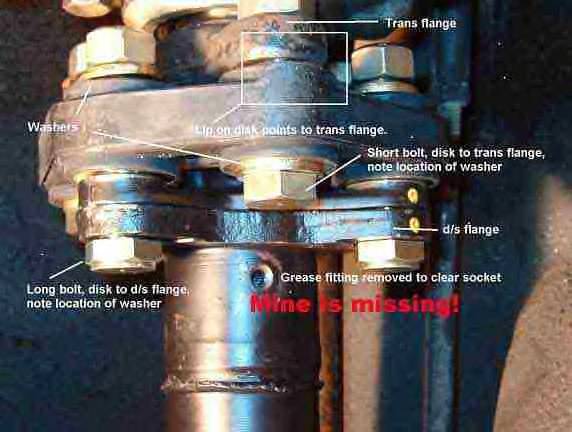

 Notice locations of the long and short diveshaft bolts and the washers. Review the diagrams, this is critical. Notice that three of the washers are positioned under the bolt heads and the other three under the nuts of the other three bolts. In every case the washers are positioned next to the rubber flex disc. The nylock nuts can be reused if the condition is ok and everything is re-assembled correctly. The driveshaft bolts should be quite tight and you may feel the nuts bottom out against the bolt shoulder as you tighten them down.

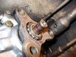

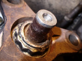

(Rather than start a new thread under the heading of "What next?", I think that I found the right spot for this question).
With my flex disc off, went to look at the tranny output slotted nut so that I could make the tool to re-torque it, and I found this arrangement:
Anyone seen this before (I hope)? How do you loosen it/torque it?
Andy   Sarasota, FL

With my flex disc off, went to look at the tranny output slotted nut so that I could make the tool to re-torque it, and I found this arrangement.../... How do you loosen it/torque it?
Someone was clearly there before you...! :D
Probably they wrecked the original, slotted nut (due to not using a good enough tool).
This on your car is a nut from a more modern M-B (80-ies), where this type of nut is used to lock the rear driving axle, at the rear wheel hub.
Unscrew it with a suitable toothed 12-point deep socket (borrow at local M-B shop perhaps... :?: )
