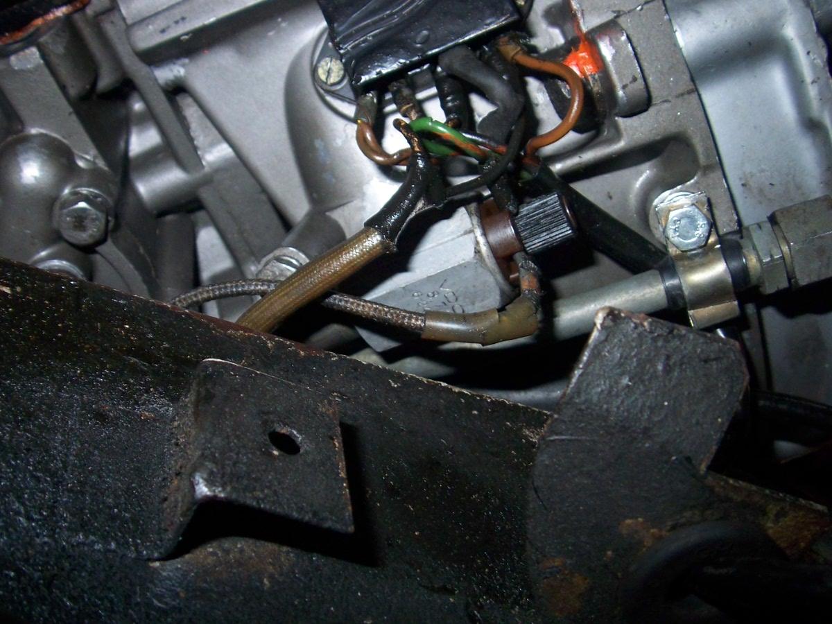

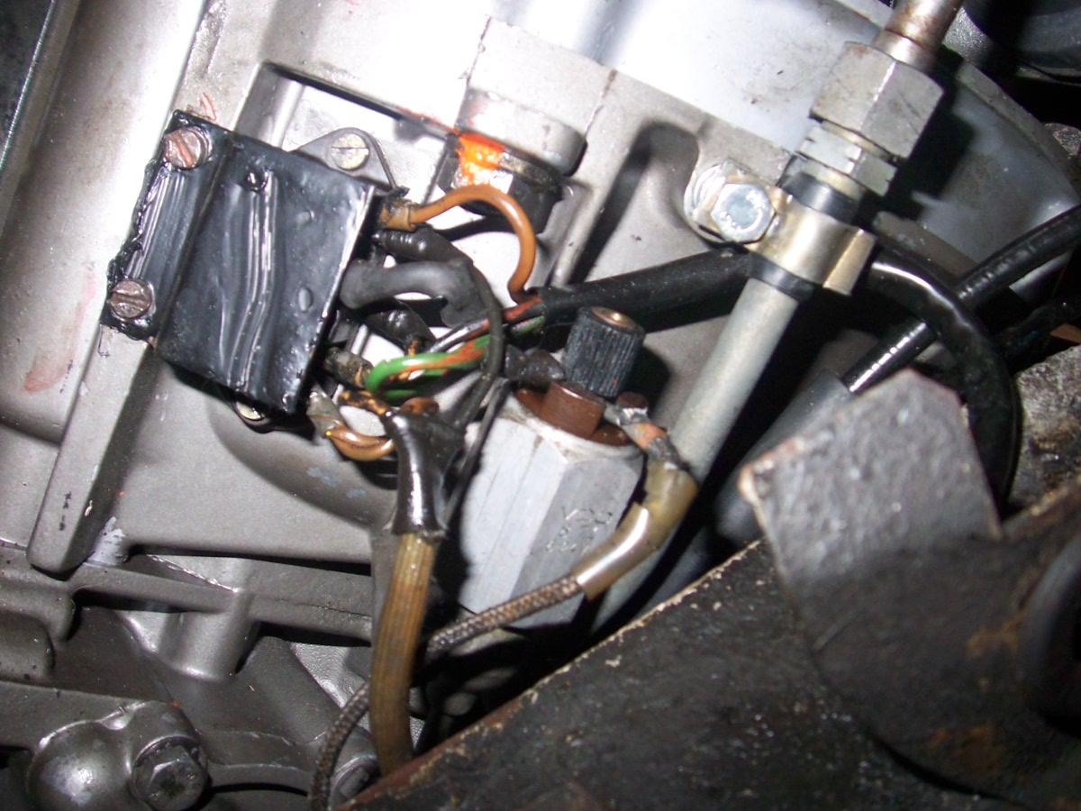

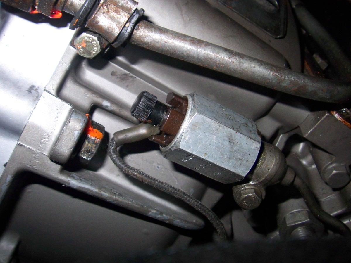

I have attached the photos.
you can see that the switches are hooked together with the same wire then the green/red goes to the switch.
figured it would help all memebers if i attched these here

Hi Matt,
Thanks for taking and posting the pictures.
This helps!
