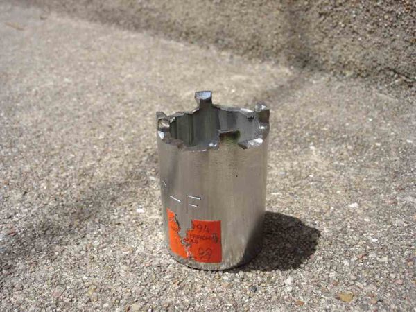

It seems to be a problem external to the transmission. The rear propshaft (drive shaft) flange nut on the gearbox output shaft has probly come loose. The speedo drive gear is friction driven and slips when the flange nut is loose.
You need to drop the prop and tighten the slotted nut and relock it.
You can make your own tool or buy one.

The nut holds the transmission output flange at the center axis, and is hidden behind the drive-shaft flex disk. You'll need to:
- First support the transmission, and then remove the transmission support plate (16 or so bolts, with the center mount bolt).
- This will allow you to disconnect the flex disc from the transmission flange.
- If you loosen the center driveshaft coupling nuts, you can simply compress the driveshaft toward the rear.
- THEN you get to check if the nut is loose or not!
The tool Naj has shown was actually made by me, and I'd offer to lend it to you, but I actually made it to fit the differential nut instead of the transmission nut. (you're free to borrow it if you need to work on the differential side though  :) )
The differential side also has the same kind of setup as the transmission, but for some reason, Mercedes made the nuts different! You can make your own, or purchase a proper one from the tool vendor Samstag. I can get you the dimensions if you're interested in making your own.
This would be a great time to replace the flex disc and/or transmission mount, if necessary.
Hope this helps!

To add to Waqas' good description:
To loosen the driveshaft (prop) center coupling you will need 42mm and 46mm open end wrenches. The jam nuts aren't real tight, just too tight for bare hands.  Hydaullic service wrenches are the cheapest in that size.
Then, if you have never messed with a flex disc, you need to search the forum for good advice with photos.  It is a good time to replace the flex disc if it shows any kind of wear.  It is critical that pay attention to disc orientation and centering and get bolt alignment and torque right.
The torquing of the output flange is easy with the Samstag socket which costs around $90.
You can also buy both differential and transmission tools as a set from ZDmak tools on flea-bay for $95 (item number 180219899757).
