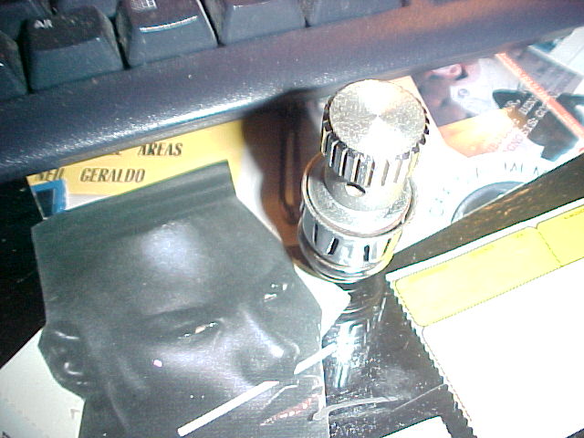

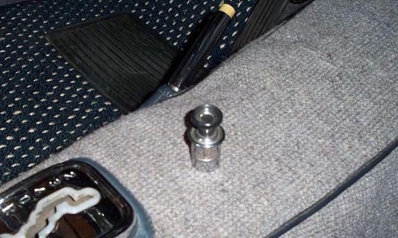

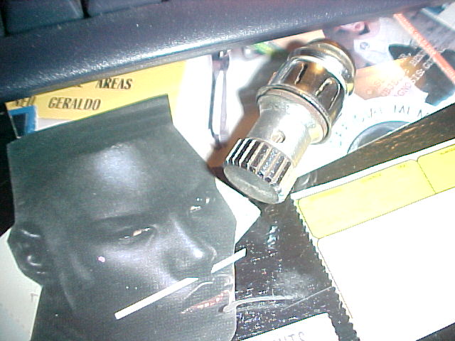

I'm tinkering with a few things while the rain persists here and got to the lighter.  Is it original for a 65 chassis 009988 (March 65)?  At first I thought not because it looks so different not to mention smaller, then someone mentioned the earlier ones are smaller, and someone else mentioned they thought the early ones were chrome.  The only marking I can find on it is "autofum."  Any help would be appreciated, pics attached.

Does not look original to me. Mine is basically like the fan control knob.
Bob G MN
Re: Original Cigarette / cigar lighter
« Reply #2 on: June 04, 2008, 19:54:57 »
This is definetely not original. Mine is Feb 65 and like Wagas it is the same as the fan control.

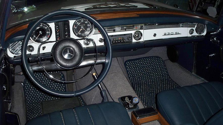

I think it should look more like this:

Are those coco mats?  They look great!
« Reply #7 on: June 04, 2008, 22:12:16 »
Good eye! Yes, thanks to the encouragement of other owners here, I added them. Very nice quality.

Is the "230SL" on the glove box lid origanal to that spot? I don't remember seeing this on other cars...

James has the correct lighter.  And no, but I've seen the emblem put there by a few owners.
« Reply #10 on: June 05, 2008, 14:34:37 »
I imagine the 230SL emblem was transferred over from the radio delete plate at some point. This is one of several nice interior touches that came with the car when we got it almost 30 years ago. The others include the matching blue MB-tex handbrake skirt, the smooth chrome shift-gate, and the chrome MB shift knob. While I have seen a few of these things on other cars -- never all of them on one... so that's fun. I added the cocos and a leather wheelskin just this year.

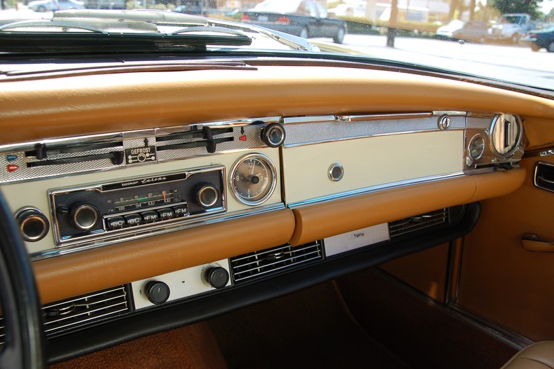

For comparison -- if you look at my last photo (interior.jpg),  you'll see all small knobs. If you look at this picture I pilfered from Ebay, you'll see the larger knobs.
Download Attachment: biggerknobs.jpg
112.88 KB
PS don't be confused by my inline photo earlier -- that one has larger knobs just on the radio...

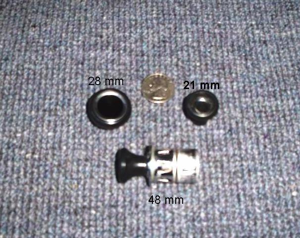

Ok. Here is what I came up with. Early knob is 21mm in diameter and 48mm long. Later radio knob (and assuming cigarette lighter) is about 28mm. I include both a later knob and an earlier one for reference.
