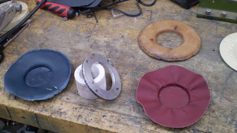

Hi Ron - -I recently recovered my 230SL horn pad.
 In the photo you can see the original mittleblau M/B Tex on the left. It took a considerable amount of effort to shape and form  the maroon leather into the concave recess, but I got good results. I think it looks great when it matches the seat covers.
I can send you the stamping die if I can find it!.
Regards, Larry in CA

Originally posted by lurtch
.. I can send you the stamping die if I can find it!. ..
Hello Larry,
can I get in line too for that tool?
How did you wrap the leather around the perimeter of the foam doughnut?
