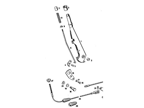

Here is an image of the handle.  Hope this helps.
Download Attachment: emerhandle.jpg
20.76 KB
Re: Emergency Brake Handle
« Reply #5 on: May 28, 2008, 09:20:08 »
Large,
The peg on #4 on Jeff's picture may have broken.
If you want to remove the handle to investigate, please note that bolt #18 in the picture has left hand thread!!

« Reply #6 on: May 29, 2008, 08:29:48 »
The problem turned out to be a simple alignment issue. The teeth had moved to a position where the pin could not engage. Cleaned and lubed everything while I was in there.  Easy 1 hour fix!
