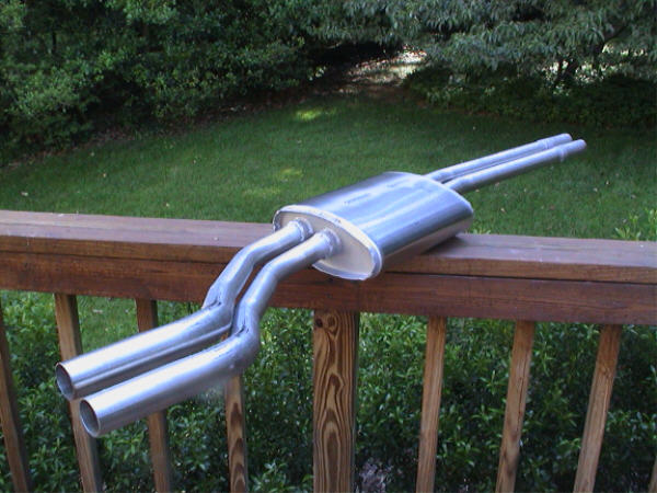

I bought the time valve system front to back and like it.  Everything fit well with plenty of overlap at the joining sections. It does take some work to get everything aligned.  Thankfully that involves moving sections front and back untill the system is where you want it.  It hangs very nice and level with no vibration or clanging due to interferance.  Other than the SS part the first muffler comes with front and rear pipes welded in place.  This is especially important for getting the right clearance with the floor, connecting to the rear muffler and getting the system to hand correctly.  The pipes go from the front muffler at a very difficult compound angle under the rear axle to the rear muffler. If this joint isn't aligned correctly with any other system you will have problems.  Having this most important joint fixed and welded in place to a factory jig makes this job a DIY. It is a little loud and I suppose it sounds a bit raspy.  I wish is sounded like a Ferrari but no such luck. (Maybe its not the mufflers fault)  I did speak with them about the mufflers and they are stainless steel inside as well as outside.  I did not use the regular u shaped clamps that tend to crimp steel systems in place forever preferring to go with band type stainless steel clamps.,  They work great and I can take it off if I need to without too much trouble.
Download Attachment: frmuffler.JPG
64.22 KB
