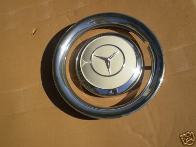

« Reply #13 on: February 14, 2008, 19:17:51 »
Just a little side note to this thread... I just received a hub cap and rim I won on Ebay. (sorry if I beat out any of you all -- I needed a 5th rim for the verticle spare). Good deal -- nice item. Anyway, I think it is the 670 -- and is really very pretty. Next week it will become 332 Dunkleblau. But I just wanted to tell Bob. Your car will be beautuful...

If I had seen it, I might have given you a run. I just need the beauty ring, though. One of mine has a little curb rash.
It's on the list of things to shop for when I make a little trip to the other side of Lake St Claire...

Hi James, thanks for the pic of the hub.  Looks nice!
