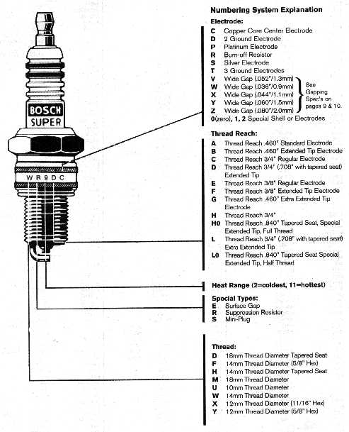

Hi Dan,
what is the difference between a W9DCo and a W9DC?

Perhaps this Spark Plug nomenclature chart will be helpful.
Richard M
Download Attachment: sparkplug.jpg
Thanks Richard.
It is quite helpful - now I know that the "zero" stands for "special shell or electrode" - but perhaps what I should have asked the good doctor was why the difference between a W9DC ad a W9DC0 is significant and/or important.
