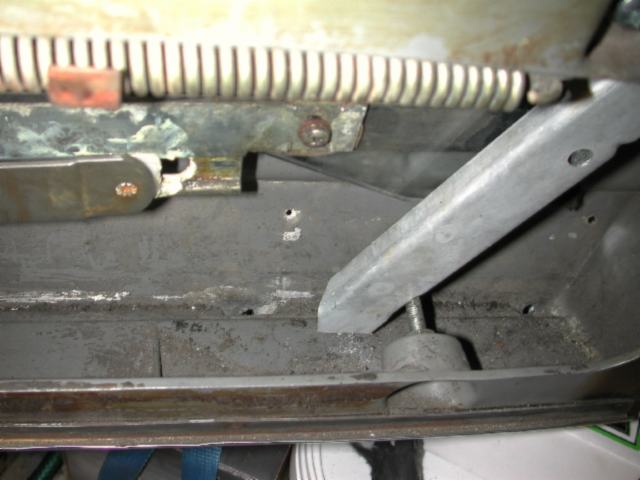

Hello, Bruce,
If you have the door apart and you did not find the glass guides at the bottom of the door, then it means they are still stuck to the glass (unless somebody else got there first and chucked them [:(!]). If you want to use the felt anti-rattle channels, these guides need to be off the glass, otherwise the will just push the felts out when you raise the glass. Taking the guides off may break the glass!!
Download Attachment: DrGlass004.JPG
38.8 KB
The adjusting screws on the guides can be accessed thru the hole on the aluminum drain channel (see picture). The front guide has one screw while the rears have two. Wind the glass up or down till you see the slot of the screw thru the hole. Tighten fully and then back off 1/4 to 1/2 turn to get smooth movement.
There is also one more adjuster on the top front guide at the top of the door aperture. The inner whisker will have to come to access that one.
Hope this helps.
Happy fixing

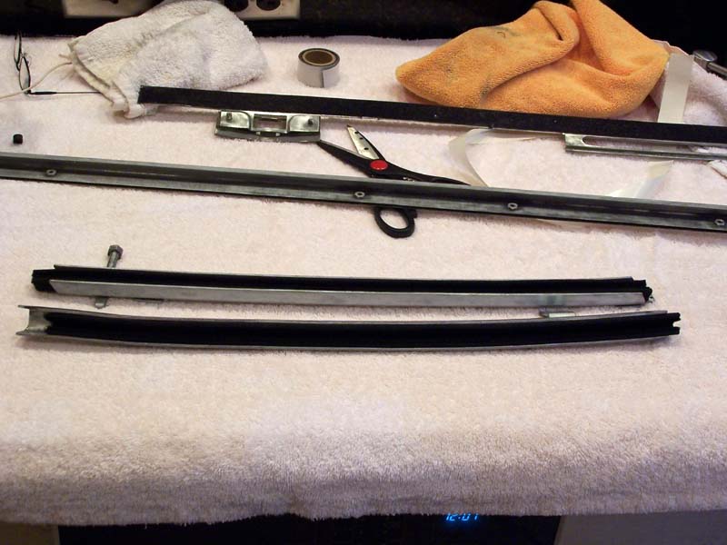

Bud's kit is simply welting that is/was used on all old cars of the 40's as felted tracking that the glass rides up on.  You can see this stuff on old cars where the glass on the door is fully framed: the welting provides the smooth bearing surface in which the glass rides.  There's no magic to Bud's kit, which is simply 4 pieces of this stuff.  I believe the stuff is actually called "window felt" and somebody must make the stuff and sell it by the foot.  For those that have not seen it, it is a combination of metal, rubber and felt.
I got the Bud's kit and am not exactly happy with it.  When the window is all the way up there is very little support of the glass, thus you can wobble it back and forth.  This might be alleviated a bit if you very carefully compress the welting to form a firm fit on the glass.
I used silicone rubber adhesive to glue the welting into the track.  If you've had things apart you might find a lot of issues inside the door as I did with mine; all kinds of things needed cleaning and lubrication, the tracks needed de-rusting.
I have not been able to get the window re-adjusted properly.  I can't close it with the glass all the way up as the top of the glass won't fit into rubber weatherstripping on the soft top.  I have to have it down a bit before closing the door.  If I adjust it a bit lower there's a "crack" at the front seal.  I gave up for the moment, saving my pennies to take it to Gernold.
Another issue I found was the rattles--I thought it was the old clamps on the glass but this was not the case.  In my case the rattles were only when the glass was all the way down, and it was the metal arms of the lifting mechanism hitting the bottom of the door; then telegraphing the vibrations througout the entire glass and door internals.  I put some padding on the bottom of the door as a cushion.  If I adjusted it so the bottom of the lifting mechanism doesn't hit the bottom of the door, the glass was not all the way down!  Jeez!
I should have left it all alone!  Needless to say I have not been in a rush to do the passenger side yet.
BTW my original clamps were firmly fixed to the glass but when loosened by the screw just came off with no persuasion.  If yours are firmly stuck, these are not the source of your rattles and I'd think twice about what you are getting into!
The attached photo shows the welting glued into the two tracks, but before trimming.
Download Attachment: Door Internals Small.jpg
84 KB
« Last Edit: January 06, 2007, 17:04:06 by mdsalemi »
