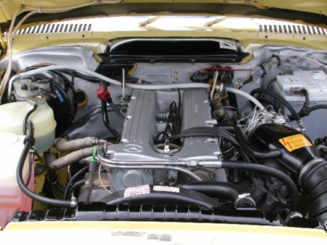

One of them:
Download Attachment: 280SL_TwinCam.JPG
52.22 KB
