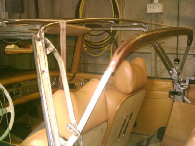

Yes,
A soft top frame for a start!
Download Attachment: softtop 002.jpg

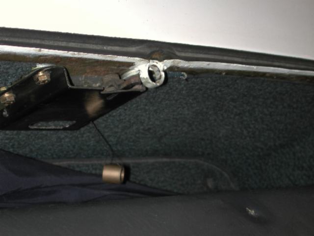

And lock:
