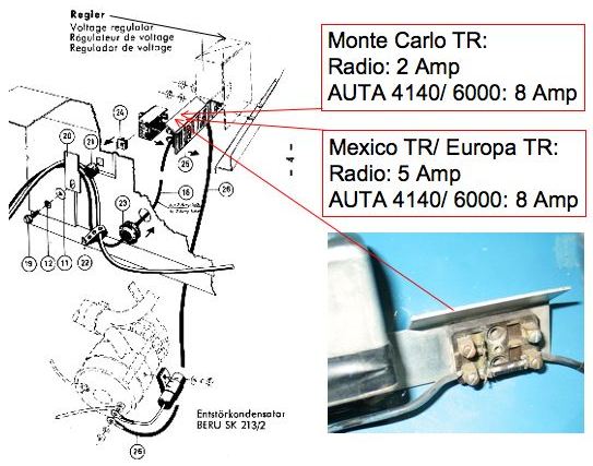

by coincidence I have just received a copy of the original installation instructions (in German) for  Becker TR Monte Carlo/Europa/Mexico radios with automatic antennas (4140L/6000D). The 8 A fuse was used for the antenna and the other slot either had a 2 A for the Monte Carlo or a 5 A fuse for the others.
So, it depends on which radio you have installed.  Unfortunately I don't have instructions for later models but I do know that a Mexico casette radio also uses a 5 A.  I wonder what my Europa II Stereo requires - need to call Tom Mitchell and find out.
The current replacement antenna AUTA 2040 also needs a 5A fuse.
David Gallon sells the 5 A fuses if you want them.

I just read some stuff on the Web telling me that an over-rated fuse is a pretty bad thing. So guess what? -- I just went and undid what I did yesterday! It is now just a matter of plugging into the old wire (that has a 5 amp in line fuse by the way) or the new one to the auxilliary box. Once I find a 5 AMP BGC, I will switch again... anyone have one handy?
(or whatever size goes to a Europa II).
« Last Edit: September 29, 2007, 16:47:14 by J. Huber »
