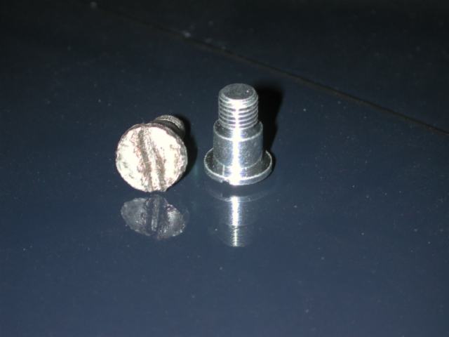

Hello, Gus,
Are these the right screws (the old one come off my frame as well and the threads were damaged)? The pitch is 1mm but the screw is shouldered.
If so, I'll have to find you the part # 113 984 1331 (+ flat washer 113 990 1040).
« Last Edit: August 06, 2007, 02:44:05 by naj »

Re: Screw size
« Reply #8 on: August 03, 2007, 13:43:02 »
MB Dearler still can order the screw shown - the countersunk one (2 reg) age no long available.

69280sl
  • USA, IL, Elk Grove
  • Posts: 573
Re: Screw size
« Reply #9 on: August 03, 2007, 15:22:13 »
Yes Naj, thats the one. I'll contact the Classic Center with the p/n you provided and if they say it is available, I will order a couple.
