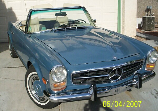

Looked at a wonderful car in the last two weeks and really appreciate the feedback I got from my earlier post (http://index.php?topic=7221).
I drove the car a couple of times, found a restoration shop that spends 50% of their time on Pagodas and had them spend half a day on evaluating the car.
Though first impression was good (mechanically very good), found a ton of stuff that needs to be done:
- all rubber, ie. hoses, belts, engine mount, seals etc need to be replaced
- some rust, pretty minor as it is a Nevada car that needs to be fixed
- which results in the need of a paintjob
- Transmission is at the end of its life
- Seats need to be reupholstered
- Softtop needs replacement
- tires are too old
Now here are my questions for you:
I got a quote for replacing all the tubes, belts, hoses, engine mounts including full service of the engine (60,000m service) at $2500 - does that sound reasonable?
Rust removal and paintjob at $5000 - same question
Paint: Car is original color baby blue (I think it is called Horizon Blue) with white interior. I am not a huge fan of the color, but don't mind it too much. What impact on value would it have if I change the color to a different original MB color?
Upholstery: Material appears to be vinyl rather than leather - has anyone got any inside on what was used 40yrs ago?
Softtop: does anyone have a source for a replacement softtop and how much do they typically run? It is unlikely that I ever put the top up, thus the question is if it is smart to buy a new one as they won't get any better being permanently in their cubbyhole.
Transmission (Auto) - anyone got a source for good rebuild trannies?
Tires - where the original tires whitewall tires? Any particular tire type you would recommend to stay original?
Tks a lot for your help
I got a quote for replacing all the tubes, belts, hoses, engine mounts including full service of the engine (60,000m service) at $2500 - does that sound reasonable? -- strikes me as very high. Wonder what they mean by "all".
Rust removal and paintjob at $5000 - same question -- strikes me as low. But paint jobs vary (in price and in quality).
What impact on value would it have if I change the color to a different original MB color? -- might change it a little if you want top dollar. I think that color can be very nice -- but if you are keeping the car for a while -- pick a color you love. Just remember, you might have to paint the engine bay, dash, etc to match. Might bring that 5000 up!
Upholstery: Material appears to be vinyl rather than leather - has anyone got any inside on what was used 40yrs ago? -- It was one or the other. Most were MB-Tex but a good many also came in leather(which is a simulated leather). Not really inferior in my opinion, just different (and a little cheaper to replace).
Softtop: does anyone have a source for a replacement softtop and how much do they typically run? It is unlikely that I ever put the top up, thus the question is if it is smart to buy a new one as they won't get any better being permanently in their cubbyhole. -- GAHH makes a very good top. Installed will cost you about 1100-1200.
Transmission (Auto) - anyone got a source for good rebuild trannies? -- No experience here.
Tires - where the original tires whitewall tires? Any particular tire type you would recommend to stay original? -- They might have been. You would need to check your build card. Check the thread here on tires. Lost of discussion about the best ones out there. I think w/w looks good on your color combo.
Much of this is discussed A LOT in various threads. Have a look! Good luck.
