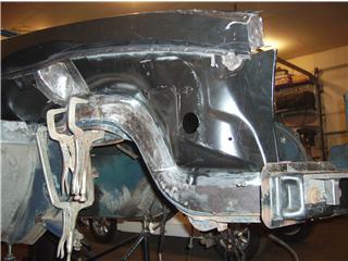

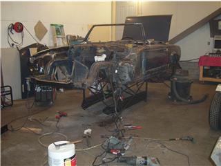

Could be worse...
Download Attachment: 777.jpg
14.9 KB
Download Attachment: 778.jpg
18.48 KB
If you ever get discouraged this helps.
