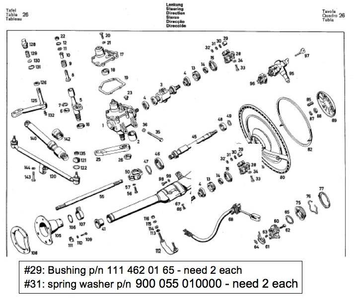

Can anyone confirm the part number for the steering coupler bushings on the W113?  The dealer was not positive on the parts they ordered:
111 462 01 65
Any help would be appreciated,
g
  • Posts: 4774
Re: directional ambivalence
« Reply #4 on: July 05, 2007, 15:13:05 »
'g',
part number 111 462 01 65  is item #29 in the attached picture. Hope this is the part you need; also you'll need 2 of them.
Download Attachment: SteeringParts.jpg
59.1 KB

enochbell
« Reply #5 on: July 05, 2007, 15:56:16 »
Thanks, that is the part.  And can you believe the dealer (in Atlanta) had it in stock?
