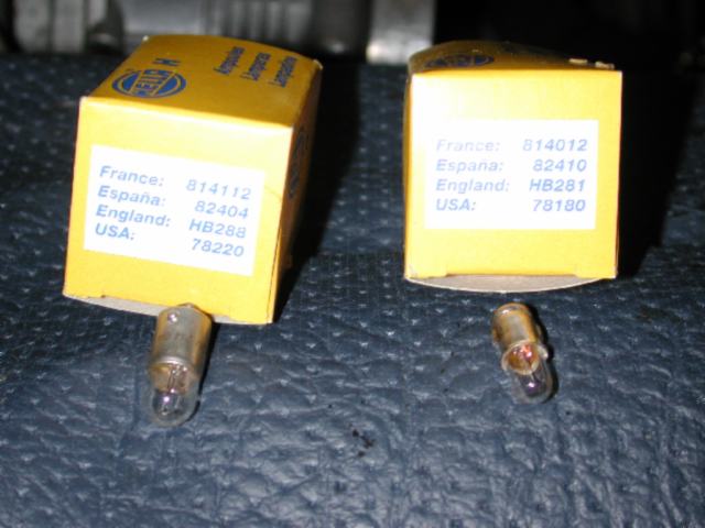

Classic Center advised that all dash lights including the heater lever lamps are the same and provided a part number. I ordered accordingly. In my car at least, the heater lever lamps are different and smaller.
Can anyone help with a number and hopefully a source?

Re: Heater lever lamps
« Reply #4 on: June 09, 2007, 08:07:49 »
Gus,
I believe the bulb you're after is the one on the right?
78180 in 'USA speak' (Size BA 7s).
« Reply #5 on: June 09, 2007, 12:12:55 »
Thanks Naj. I made another call to the Classic Center. This time (same person) gave me a different MB part # for the heater lever lamps. It is 072601 012800.

« Reply #6 on: June 09, 2007, 12:33:33 »
Just got out to the garage to install the "new" heater lever lamps. They are still wrong. What I got was more instrument bulbs. Ignoe the p/n in the previous post if you are after heater lever lamps. I'll try to get them elsewhere with the Hella number Naj provided.

« Reply #7 on: June 14, 2007, 09:09:21 »
I hope this saves someone some time and annoyance.
TopBulb, www.TopBulb.com, has these. Thier item number is O-3898. The price is $1.99 each, but there is a flat $7.95 shipping charge regardless of order size.
Generically the bulb is BA7s, as Naj advised.
