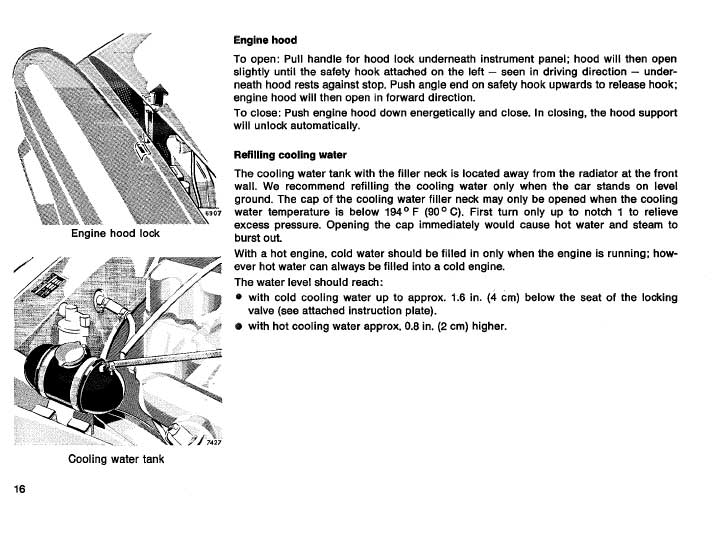

Hi Guys...
Per the manual, you're doing it the right way...  dont drop and slam it...
See attached pic for info from the manual.

To be honest you could interpret the instructions on that attachement both ways "Push down engergetically "
My hood wont close if I drop it, I have always just pushed it firmly, and there is the merest of deformation there now !
