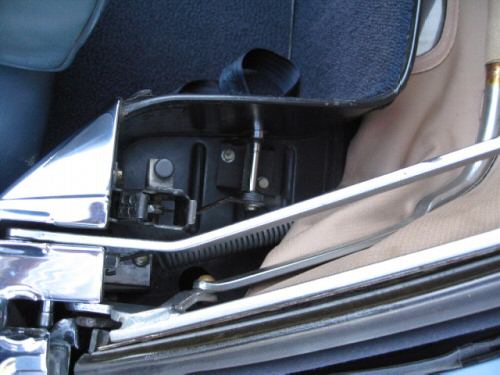

« Reply #6 on: June 10, 2007, 16:42:33 »
This is a good pic of the latter style receiver, the early one (I still am looking for a pic) does not have the inboard half-circle raised area.
g
