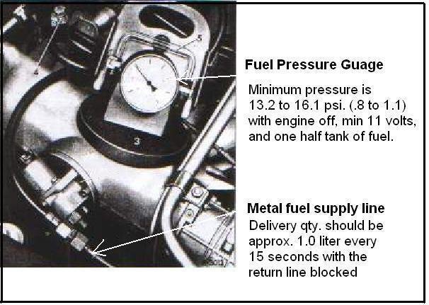

have you checked the fuel pressure?  It is easy to check it at the csv connection.

I checked the ballaster & it is at 12v.  Iam not able to run the engine to get get it warm to check the warm up device. Is there another way to check it?  When I give it more throttle at start up, it runs only on about 2 or 3 cylinders. I need more info on checking fuel pressure at the CSV & what should be the pressure?

Regarding fuel pressure, here's the relevant data (thanks to ja17) :
http://www.sl113.org/forums/uploaded/ja17/20062593139_pressure%20check.JPG
