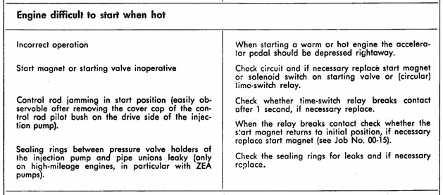

In the Workshop Manual appears a new word: "rightaway", in the operation of starting a hot engine (together with other causes of the problem):
What's the meaning of this word?
Albert de la Torre Chavalera

Albert,
They simply left a space out.  It should be "right away", as in "right now" or "right at that moment".

Albert-230sl,
rightaway means immediately
