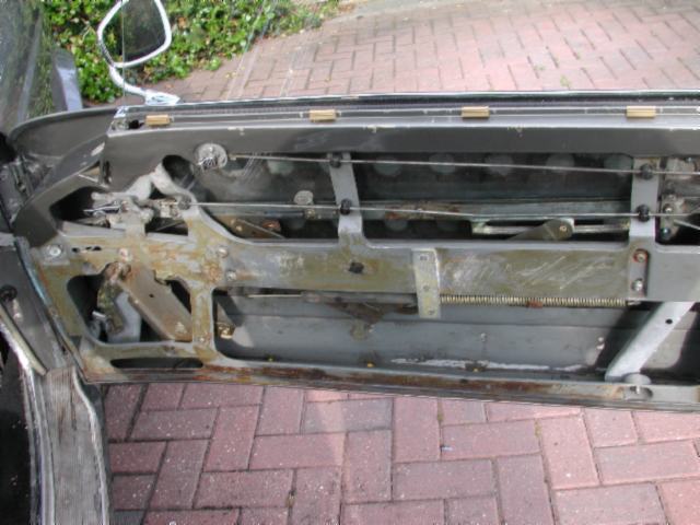

If you disconnect the 2 window regulator arms from the bottom of the glass rail and also, remove the two bottom stops, you may be able to drop the glass deep enough in the door to be able to replace the insert on the top front jaw. The inserts are handed left and right so to you need the correct one.
Download Attachment: DrGls03.JPG

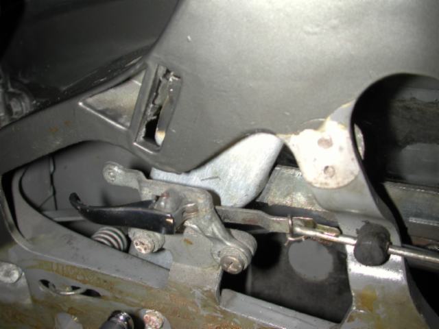

One 'cheap repair' solution is to add a little coil spring to pull the operating rod back.
Hope you can see it tucked under the rod in the picture.
Download Attachment: DrGlass007.JPG

That isn't the return spring for the door release. It is a device to prevent the door from opening from inside when locked.
I am posting a seperate thread to show where the return spring breaks and how I have repaired them.
Al

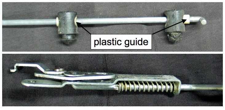

That small spring on the rod is there to prevent the handle inside from breaking or snapping off when one tries to open a locked door.  When the door is locked the handle inside can still be pulled out to the open position with a strong tension, but wont break.
Alfred is right that the plastic guides should be cleaned and lubed to allow the handle to return to the right place when unlocked, if the spring inside the door catch assembly is ok.
I just simply remove them and shoot a lot of brake cleaner inside to clean out the dirt and gunk and then do a liquid grease coating(should be lithium based).  Then work it a few times to ensure everything s smooth.
Walter
Walter
