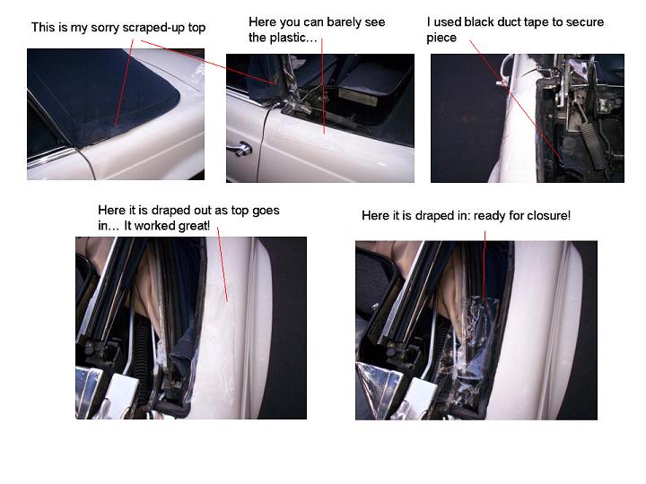

Ok. So I did a little playing today. I found a heavy clear plastic bag that one of the kid's foldable beach chairs came in. Decided to chop it up in the name of Pagoda science. I cut about a 6" wide by 10" long piece (2 of them), and taped them into the soft top well. It may not be as ideal as the Mechatronic version but I think it may just work...
Download Attachment: Soft-top1.jpg
55.79 KB

Very nice and sanitary installation, James!  I've been using a pair of thick 1-quart ziplock freezer bags for this.  The main thing is to have a slick surface for the top material to slide past the rubber gasket.
« Last Edit: March 24, 2007, 16:00:24 by Mike Hughes »

Why thanks everyone for the kudos but I really just went on Hauser's idea...It is so simplified -- but seems like it will work in a "pinch!" yuk yuk..
So, now I have to buy a new soft-top. You'll be hearing from me...
And Douglas, I have tried to rectify that curl thing -- but don't quite have the technique. First of all, I try to push the edge down as my top recedes into the well, but then my fingers are in there too. Also, how the heck can I do both sides?
