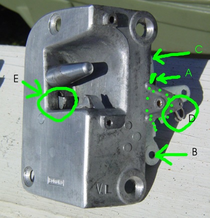

Left side door latch
A. Location of the broken spring (dotted line). It is sandwitched between levers B.&C. and held in place by the rivet they pivot on.
B. Door release lever the controll rod attaches to.
C. Lock lever controll rod attaches here.
D. Toggle spring for locking mechanism.
E. Lock out lever. This button needs to be pushed in to allow the lock lever to move to the locked position.

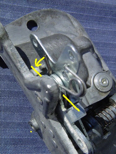

Half of the spring is missing on this latch. The remaining end is visible next to arrow and when the spring is in place its ends rest where the yellow lines indicate.
The first step in replacing the spring is to remove the toggle spring(D.) Then lift the end of spring (A.) up over the locking lever (C.) then wind it out similar to how you would remove a key from a key-ring.

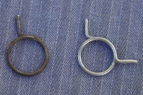

The spring on the left is from a left door latch, the right from a right side latch. The left one spirals to the left, the right to the right (the same as screw threads) I don't think which way the replacement spring is wound will make a great deal of difference in how it works though.
The broken coil measures 20mm O.D. I found a coil tension spring at the hardware store that is a little bigger than 3/4" and has a slightly smaller wire guage. When I put the 2 broken spring pieces back together it made a loop of 450deg. (360+90 more)
Cut off a section from the new coil spring and fashion it to match the old one, then wind it back in over the locking lever, opposite of how the old spring was removed.
When the new spring is in place between the levers, locate one end in the notch in the aluminum housing, then (this is the hard part) pull the other end with a pair of long nose pliars around and up between the gap where the release lever contacts the lock lever. The tab on the end of the spring may have to be bent slightly upward to get it through. After the spring is resting on the tab of the release lever it can be bent back down to where it lays flat and clear of the locking lever.

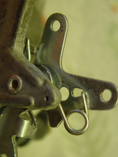

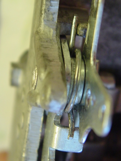

New spring in place viewed from front
Once the new spring is in place, reinstall the toggle spring to the lock lever, check the lock and latch for proper operation and reinstall the latch back in the door.
