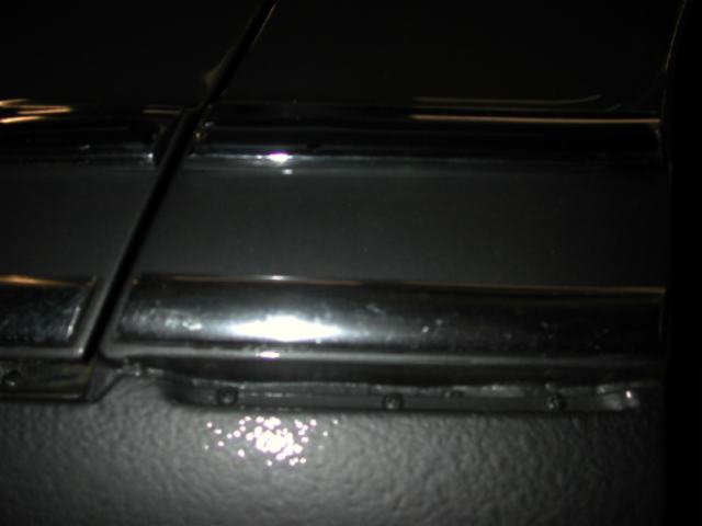

« Reply #3 on: February 17, 2007, 09:00:48 »
Barlow,
a plastic drain tube hanging down from the ragtop well,the drain tube dosen't seem to have an exit point. Is there a exit point location?
If you insert a thin long rod thru the drain hole. it should show up in the gap below the lower trim
Download Attachment: Wtr_drn049.JPG
