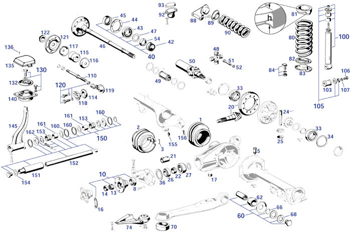

Thanks Guys!  Jeff, the lower carrier mount that I am referring to is a metal tube surrounded by rubber, then encased in another metal tube.  See attached pic from SLS, item #151.
I purchased this part a while back and after reading some posts and other info, decided not to take a chance and screw up the rear end by replacing this part.  The rubber that is exposed is deteriorated.  Joe A. mentioned that it may be possible that the inner rubber, the area not visible, still may be intact.  So left this project go.
Based on this discussion so far, looks like I may pass on this one again?  Just focus on the new drive shaft and new pinion seal…  Still thinking on this…

I think it is important to relieve tension on the pivot pin and stabilize all the components to minimize shifting.  I'm not sure having weight on the axles provides sufficient flexibility for relieving this tension.  With the rear of the car suspended on jack stands under the side rails spring tension is reduced.  A jack under the center diff and one properly placed under each axle tube would seem to provide the adjustability you may need to minimize tension on the pivot pin. I'll defer to others that have done this job with the axle on the car.  I've done it with the axle off.  Be carefull when forcing the pin to the rear not to push the chrome plated bushing # 161 out of the brass eyelet in the right axle tube.  If you do re-alignment will be more difficult. My experience with this bushing indicates that it is going to want to stay with the pivot pin versus the axle tube eyelet. Remember to remove the nut and punch out the locking bolt #162 or the shaft will be locked in place.  When returning the pivot pin make sure the pin as not rotated because the locking bolt has to mesh with a flat spot on the pivot pin.
