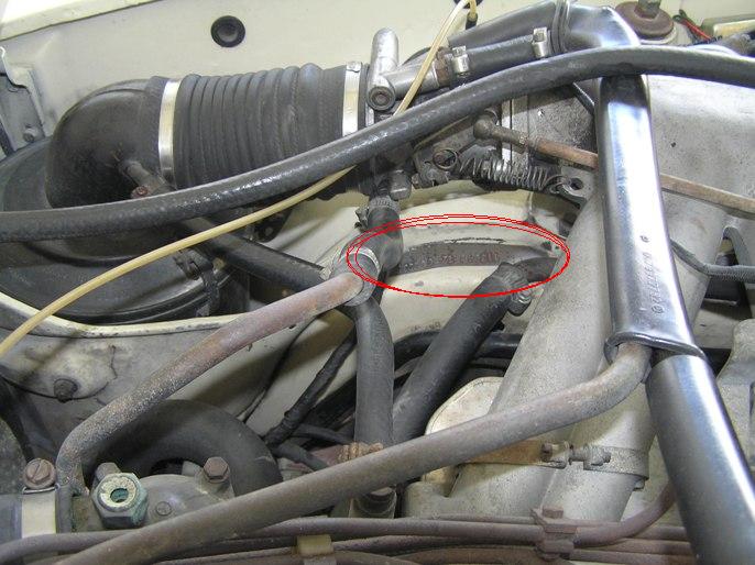

Mike,
Have a look on the right chassis leg in the engine bay under the throttle body area. You may have to scrape off some paint.
It should be stamped there.
Download Attachment: ID3_Chas.JPG
46.98 KB
Good luck

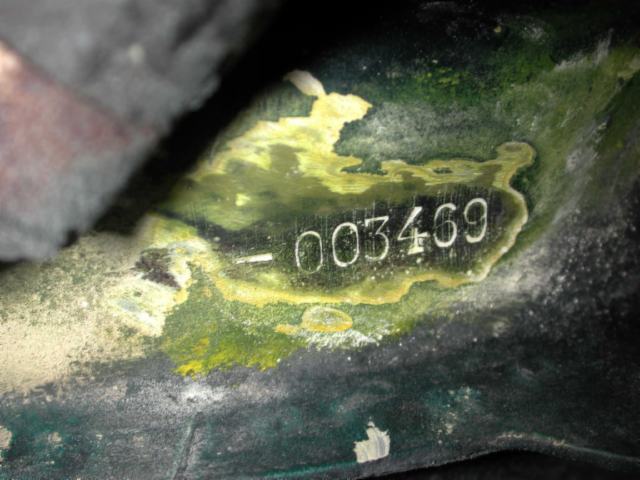

Mike,
  Check the photo attached to see the exact location of the Chassis # stamped on the car. As Naj mentioned you may need to wipe the paint off in some cases.
Abbas
