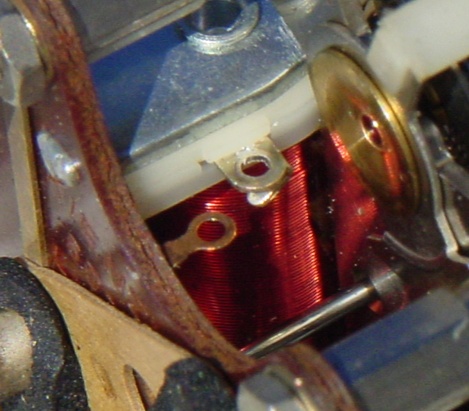

The fuse is actualy the solder that attaches the copper strap to the winding solenoid. It is a special low temperature solder that is supposed to melt if there is an overload. If the solder is gone the copper strap will pull apart from the fitting , if you look closely the one in the photo has partially separated. On this clock it is causing the solenoid to buzz instead of winding the mainspring. I just resolder them with regular rosin core solder when they come apart.

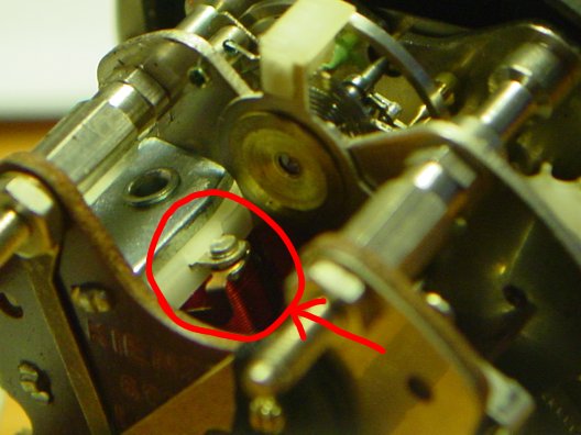

Perhaps a better hi res picture can be seen on http://www.privatpc.no/banff/455.jpg
On my clock I had to replace the hole winding mechanism due to defective spring (on the part in the left corner - arrow 2)
The soldering place is marked with arrow 1

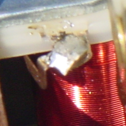

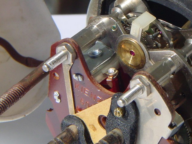

The first thing to take into consideration is this entire photo represents approx. 1 square inch. The white metal lug coming out of the insulator is the winding solenoid's electrical connection. The dull grey "post" is the low temperature solder, It was most likely installed as a rivet. The copper strap comes from the + terminal of the male plug connector, it has spring tension to pull the connection apart if the thermal material should melt out. The strand of wire in Kjell's photo is something that was added in a repair. The copper strap should be attached directly to the lug on the solenoid. As I said earlier I use rosin core solder, the thermal fuse is a redundant protection that isn't realy needed.

The original fuse material still in place:
The strap seperates from coil after the fuse is gone:

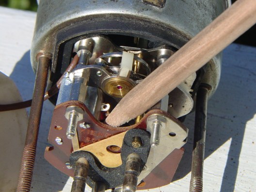

Special tool (#2 pencil) to hold strap in place:

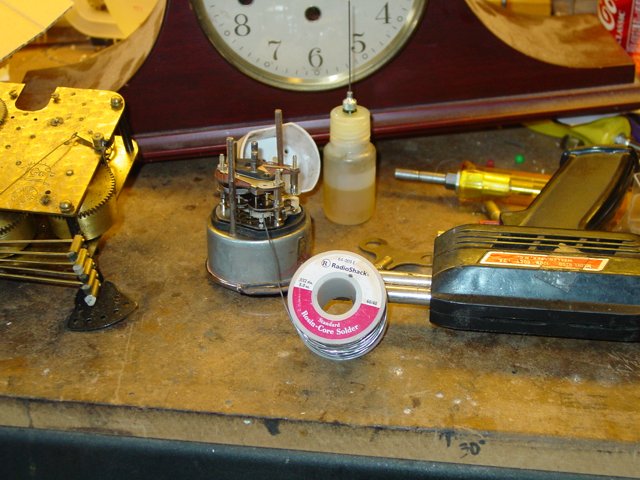

My clock bench and rosin core solder:
