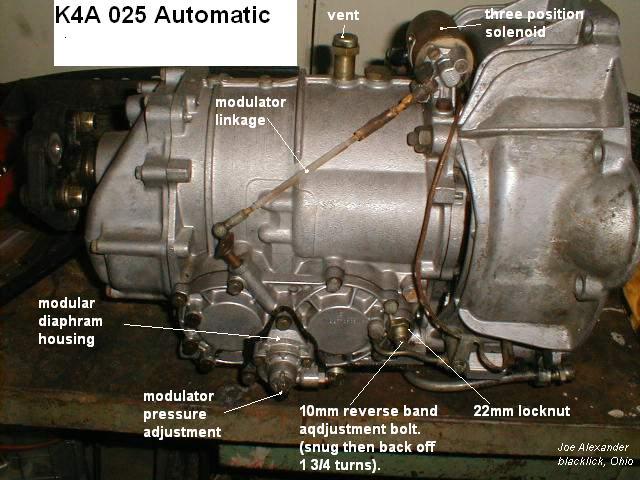

Hello Ben,
There is a reverse band adjustment that comes loose sometime.  Here is a picture with some text.
Download Attachment: K4A 025 Automatic.JPG
60.99 KB
The 22mm lock nut comes loose and the 10mm reverse band adjustment backs out. Snug the 10mm adjustment then back it off 1 3/4 turns. Lock down the adjustment nut. Hope this does it!
« Last Edit: October 08, 2006, 07:11:36 by ja17 »

Well thanks for that guys, I actually searched and spotted that and got out there to check it, but its not the problem. the adjustment was fine !!  Boo hoo !
