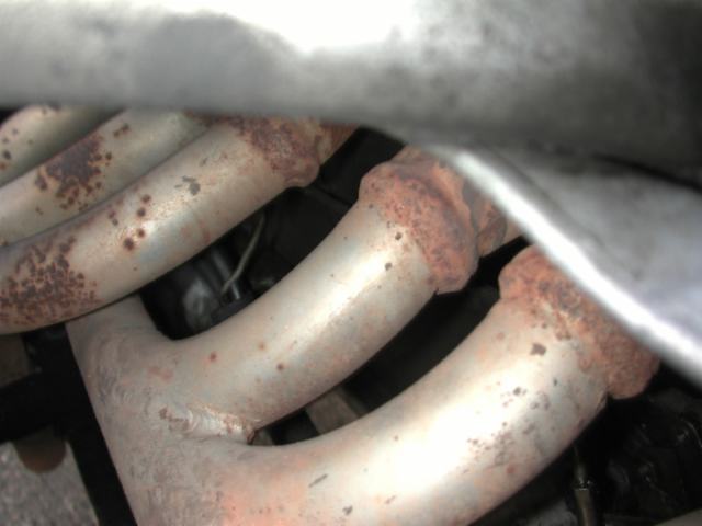

Re: Correct Exhaust manifold color for 65 230SL
« Reply #2 on: November 15, 2006, 07:32:23 »
Hello, Peter,
Does this help?
Download Attachment: 230_Header.JPG
29.3 KB
This is from a 1.2 M km. unmolested 230 SL
« Reply #3 on: November 15, 2006, 12:13:12 »
Naj's picture says it all. They are the same. I couldn't remember what color they were bacuause I sandblasted them months ago.
I thank both of you for your responses.
« Reply #4 on: November 15, 2006, 16:00:04 »
For reference, from the factory the cast iron manifolds were painted with a very light grey paint.
« Reply #7 on: November 19, 2006, 20:27:33 »
The grey finish on my '65 headers looks more like some type of thin metallic layer rather than paint. The appearance is similar to Naj's photo.
DaveB
« Reply #8 on: November 20, 2006, 06:10:02 »
The gray paint does have a bit of metallic look, but it is definitely paint.
As an alternative, I had mine metal sprayed with aluminum many years ago.  It gives the look of the origianl paint.  It is flaking off now (after 32 years).  If you go that route you must mask the areas where the mounting nuts go and all of the openings.
