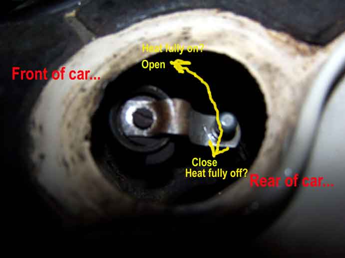

Hello All,
Please look at the attached pic.  Do I have the heat on/off direction correct on the pic or is it the other way?
Thanks!

You've got it backwards.
It could be a Deutch/English problem.
Auf means closed (in plumbing auf means off but on electricals auf means on)
are you more confused now?
Al  :O)

Re: Heater Valve - Heat On/Off ?
« Reply #2 on: November 01, 2006, 16:18:59 »
My memory from doing this job is that the top of the round valve (as I will call the part that actually turns to open and close the water passage) is square, and that you can put the arm on the top of it in any of four directions.  Thus, I believe that it is impossible to answer your question definitively from the attached photo.  (If the arm has never been removed, there may be an answer, which I guess Al has supplied.)
When I redid my valve, I made a mark on the top of the valve directly above the opening in its side.  When that mark points towards the front of the car (i.e., is lined up with the water inlet pipe), the heat is on (so to speak...).  Make sure that you reattach the arm and its linkage such that the interior heater lever is in the "on" position, and you're set.
Of course, this requires you to pull the round valve out to mark it.  See posts from folks like Arthur Dalton about how to do this, and the pitfalls involved (including the possibility of dropping the valve into the heater core).  The short advice is: Have a long screw threaded to match the little screw shown in your photo, and use it to pull the valve; never let go of it, and putting a very large washer on it will keep it from dropping down when you slip; stuff rags around where you're working so that "stuff" doesn't end up in the black hole adjacent to the heater core.
It's really not too hard, just take some care.  Good luck!
« Reply #4 on: November 01, 2006, 23:53:10 »
Hi, Bob,
Actually, I was not suggesting that you mark the valve prior to removal.
The way the valve works is that the round valve is a hollow cylinder with a hole in the side (like a tin can with the bottom cut off and a hole punched in one side).  When that hole lines up with the water inlet pipe, the water flows into the hole and out the bottom, and you have heat.  When the hole is turned away, there is no flow and no heat.
There is one other thing you need to understand about assembling the valve: there is a "limiter" (for lack of a better name) setup that controls how far the valve can rotate in either direction.  It is the dark grey piece of metal that is at about 4-6 o'clock in your photo; that piece of metal rotates within a slot that limits its movement.
So, I was suggesting that you remove the valve, then make a mark above the center of the opening in it.  After replacing the o-ring, reinsert the valve in the open (heat) position, but don't hook it up.  Move the dash heater lever and see how the linkage moves, then set the dash lever to "heat".  Orient the limiter and the arm so that when you move the dash lever to "no heat" it will move the valve towards the other end of its travel, and reassemble everything.  (Remember that the arm can be attached to the valve in any of 4 positions; also, because of the limiter, it is impossible to remove the valve without first removing the screw, arm, and limiter.)
I hope this makes some sense.

« Reply #5 on: November 02, 2006, 00:18:28 »
I was able to check my heater core (since is still not installed and sitting on the bench) and your picture is indeed correct.
[Sorry, Al].
Moving the lever in the direction to the engine opens the valve.
« Reply #8 on: November 02, 2006, 17:11:19 »
Hi, Al,
I agree with you, IF the valve has been assembled the (1 chance in 32) right way.  However, in my case, the valve had once been installed 90 degrees off, and so rotating the valve to the rear closed it.  Of course, this meant that when the door directed heat through the heater core the core was cool, but when the door let fresh air in the core was hot.  (The only way to get any heat at all was to turn the driver's control to "cool" and the passenger's to "hot", and get some heat on the passenger's side.)  Obviously, once I figured out the problem I fixed it.
However, this is why I say that you cannot tell from a photo of a disconnected arm how the valve is actually oriented.  Perhaps Alfred's valve is suffering a similar mis-assembly?
-David Pease

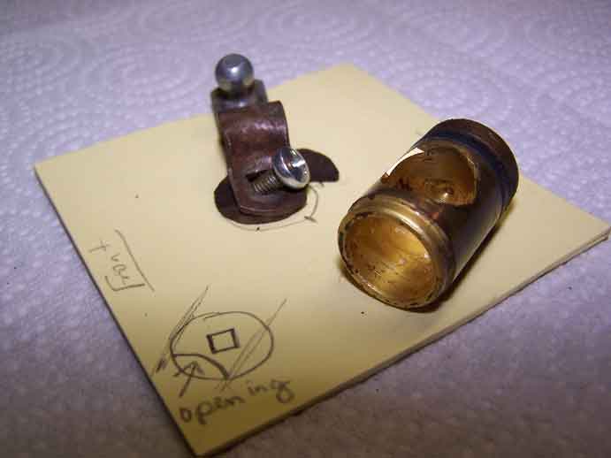

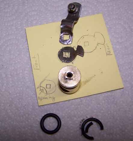

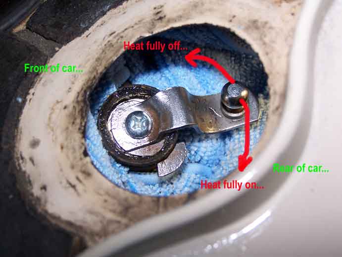

It has finally soaked in (Thanks to you guys ;) )!  I have attached some pics that I took while renewing the rubber o-ring on the valve.  The one pic shows how I drew and positioned all of the pieces as I removed them, so I could ensure that they were correctly installed again.  But, in reality, what you have been describing is really the way to go on this...
Basically, when re-installing the valve, ensure that the opening on the side of the valve is pointing forward, towards the engine.  This is the "full heat on" position.  Then ensure that the slide control in the car is moved left, and into the full heat position.  Then attach the control arm (adjusting the length as needed) to ensure a nice fit between the two balls, air flap ball and valve arm ball.  The only other important item is the travel limiter plate.  Need to ensure that this is installed so as not to limit the full on/full off stopping points of the valve.

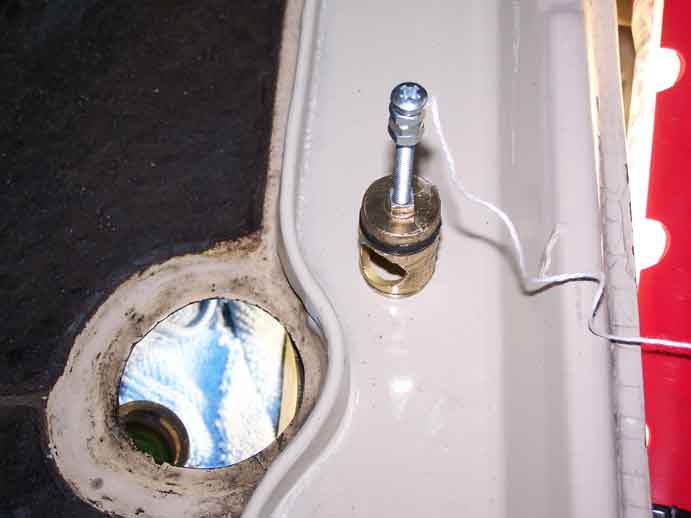

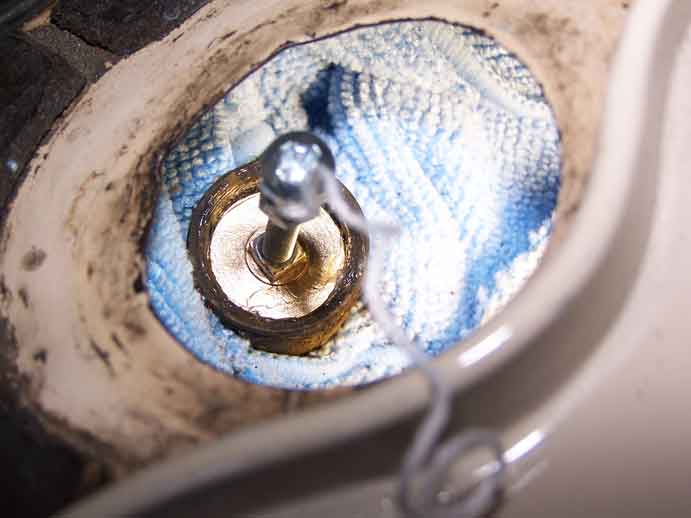

Here’s a pic showing the “puller” I used.  I used a 3 inch (4mm) screw and attached a string to the end and tied the other end to the wiper arm.  This was so that I wouldn’t loose the valve into the core while pulling it out  The longer screw also came in handy to allow me to slide the valve down a bit after removing the small screw, and arm.  You need to slide the valve down (just a hair) to the allow the travel limiter plate to be removed.  Others have suggested to remove the front heater hose and slide a wire into the front of the core opening and into the valve.  This is another option, which I didn’t use.  Bottom line, be very careful not to drop the valve into the core.  There is nothing (no ridge, lip, etc) to stop the valve from falling into the core.  It is basically held in place by the arm and eventual friction of the new rubber o-ring...
Download Attachment: valvepuller2.jpg
23.61 KB
Download Attachment: valvepuller1.jpg

Detailed pics of the valve and valve pieces.  The pic of the valve on its side shows how the radiator fluid travels thru the bottom of the valve and then thru the side opening of the valve, allowing fluid to flow thru the heater core.
Download Attachment: valvepieces.jpg
11.23 KB
Download Attachment: valveside.jpg
15.67 KB
In summary, this pic shows the correct heat on/off position (for my car)...
Download Attachment: heat-on-off.jpg
26 KB
Hope this post helps others...

How do you keep a loose valve from falling in while removing the top screw and replacing it with the valve puller. I am sure reinstalling with a new o-ring is not a problem but not sure if the o-ring has detriated?
« Reply #17 on: November 05, 2006, 12:50:27 »
Hi Bruce,
I believe it was Alfred who suggested removing the heater hose, at the firewall, and sticking a coat hanger wire into the pipe.  Need to move the valve back and forth to ensure that the coat hanger wire is sticking all the way into the valve.  This should prevent it from falling down.  I didnt need to do this because my valve was still tight in the valve shaft.  I know that I also took a chance by not following Alfred's suggestion.  Overall, not a bad little project at all...
Good Luck!
