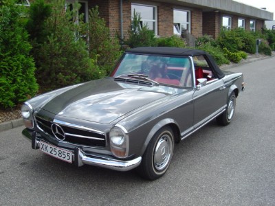

Last winter I got new frontwings and ofcause the car painted, when I got it back from the painter I could see that he had forgot to drill the holes to the antenna and the flashers :evil:
Now I have found a new painter, which can drill those holes, but we need the exactly placement of the flashers and the antenna, does anyone have a drawing or anything of this?

Yes I have an US-spec car, and I know the flashers must be in front of the frontwheel, but I don´t want to spoil the car, so I must know the exact placement of them.
The same problem with the antenna, how many centimeters from the windscreen?
