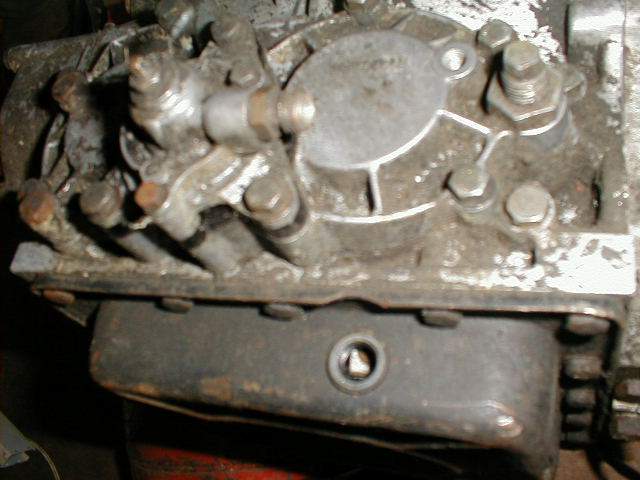

This problem is not uncommon. The large 22mm lock nut may become loose allowing the 10mm reverse band adjustment bolt to loosen. This 22mm locknut should be a checked for tightness occassionally. To re-adjust the band, the 22mm locknut should be loosened and the 10mm adjuster bolt should be just snugged (clockwise) then back the 10mm adjuster bolt out (counterclockwise) one and a three quarters turns (1 3/4). Tighten down the 22mm locknut. If the adjuster bolt becomes loose the transmission may be slow to go into reverse or may not reverse at all. If the adjuster bolt is too tight it may cause wear to the reverse band.
Here is a photo of the 22mm locknut and 10mm adjuster bolt. Good luck!
View the large 22mm lock nut with 10mm adjuster bolt on the right. The smaller adjustment on the left is the factory-set vacuum modulator adjustment.
Download Attachment: P1010144.jpg
40.85 KB
One easy way to drain off excessive transmission fluid is to loosen the rubber transmission line at the base of the radiator. Start the engine and allow some fluid to escape.
