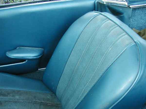

Hello Pagoda-Pals:
At long last,  I have the power-train of my '66  230SL in exceptionally good running order and I am ready to explore  re-upholstery options .
The data card block for my car  specifies "123", also known as "mittelblau", or medium blue.
I am finding that there is a problem with the  color availability of this particular vinyl.
It seems that this color was dropped in favor of the  darker blue (almost Navy)  when the earlier 113's morphed into 250SL's.
World Upholstery informs me that "mittelblau" is no longer available. They also say if I order their seat covers they will be the darker blue.
PerfectFit-McDonald  informs me that they do not have that color of spray-on dye available either.
Garys Uphlostery has numerous types and close-match colors of vinyl, as does Denver Fabrics, but I am conflicted about going in that direction.
I have not yet tried the German vendors.
 A further complication is that some of my vinyl surfaces do not need to be recovered. Therefore, it is possible that  I may wind up with a mish-mash of  three different colors of blue.
Have any of you folks already navigated this minefield? Should I resign myself to retrofitting the entire interior to the wrong color?  also - - writing a large check to an upholstery shop is not an option I wish to pursue - - -
Thanks for any help and advice,   Larry in CA

Larry,
Can't you get a vinyl dye made up in middle blue? I know Leatherique will mix colors to match a swatch. At least, that will guarantee uniformity in the job at its completion.

Is the interior you currently have correct and original ??
From that photo it doesnt appear to be as then centre parts of the seats were always the same colour, plus your door trim does not appear to be original ?
Not criticising obviously just hoping to help you avoid making a mistake !

Good eye, Ben.  I noticed the basket weave sections were different, but I did not notice the lack of the horizontal seams in the door panel.
Even though the current interior may be a replacement, he's still having a hard time finding anyone to supply the correct code on new material.

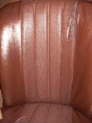

I am having the same problem myself with interior #113 bronze/brown. My 230 SL was produced in October 1966 so probably within a year of your car. All of the usual suspects are offering a dark brown for (the later cars) that is missing the "gold-ish red-ish" tones in my upholstery. I checked with Gernold at SL Tech and two German suppliers...same story. A local guy here says that we can try to get a close match and then send a piece to World Upolstery or GAHH to have covers made. Still they will never be "right" against the other panels and of course, no basket weave in the center panels  :( .
Let me know what you end up doing or vice versa, I have not made definitive plans as yet. An upolstery shop specializing in older Mercedes suggested sheepskin covers but I am not willing to give up as yet.
Kevin

Thanks for the advice. I went to a restoration shop locally (was not driving my car that day). He reports that I can pick a vinyl with as close as possible match to mine and then send to GAHH or World and they will make the 113 covers (sans basket weave) for me. Will probably go that route.
Thanks!
