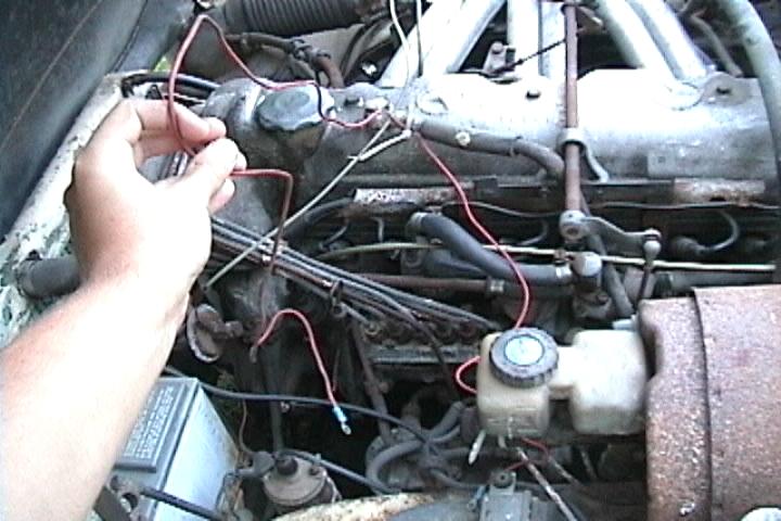

Found this cable under the hood, small red wire. It's zip tied to some other parts, but it's disconnected... anyone recognize it?

Are both ends disconnected?  Do both ends have the same type of connector?  What was it tied to?

I could be wrong, but It looks like an aftermarket wire like for an alarm or something. What is the other end connected to?

Certainly not original Merc wiring!
Where is the breather pipe from the top of the valve cover going to?

wire looks heavy enough and long enough for fog lights.  is it connected to a relay near the other electricals next to brake booster?

That breather pipe from the top of the valve cover (by the oil cap) looks to be routed to the ground.  That's how mine was when I bought my car.  It's because too much oil blow-by is up under the valve cover and this oily gas & liquid gets pushed back to the venturi unit and intake manifold.  People route this pipe to the ground which allows you to better tune the engine air/fuel mixture.  That's my take on it.

Neither of the ends are connected.

Rip the wire out.  Also, please fix your Closed Crancase Ventilation System if it is indeed disconnected. This is the most rudimentary and basic pollution control a car can have, and should really be correct. These cars pollute enough, even if we only drive them "a little".

Yes that wire is definately an add on. Mercedes wiring is usually sheathed in a black cover. The blue ring terminal on the end of the wire is also non Mercedes. This kind of add-on is usually done by someone adding a radio, fog lights, horns, alarm or some other add-on.
