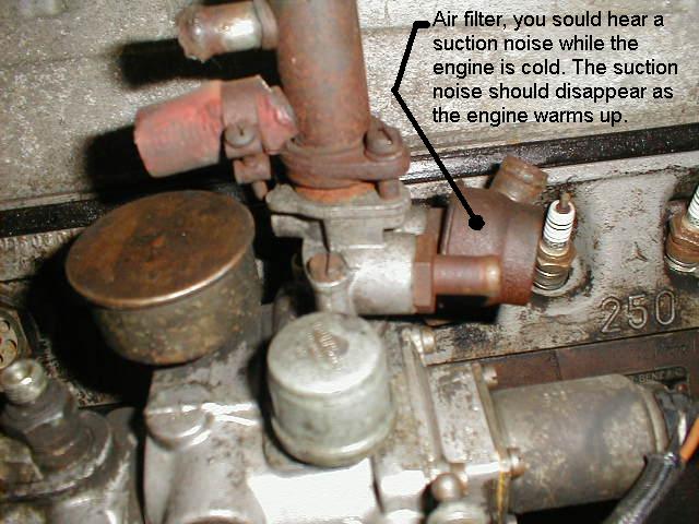

Hello newbe,
It sounds like you have a stuck warm up device on the injection pump. This can be easily checked. Start the car with the engine cold and listen for a suction sound at the small air filter on the injection pump. You can use a section of hose as a stethoscope to listen for the suction sound.
Download Attachment: WRD device.JPG
65.97 KB
If you do not hear any suction noise at this air filter when the engine is cold then the mechanism may be stuck. After the engine warms up it is normal for the suction noise to disappear.
« Last Edit: August 03, 2006, 22:37:54 by ja17 »
